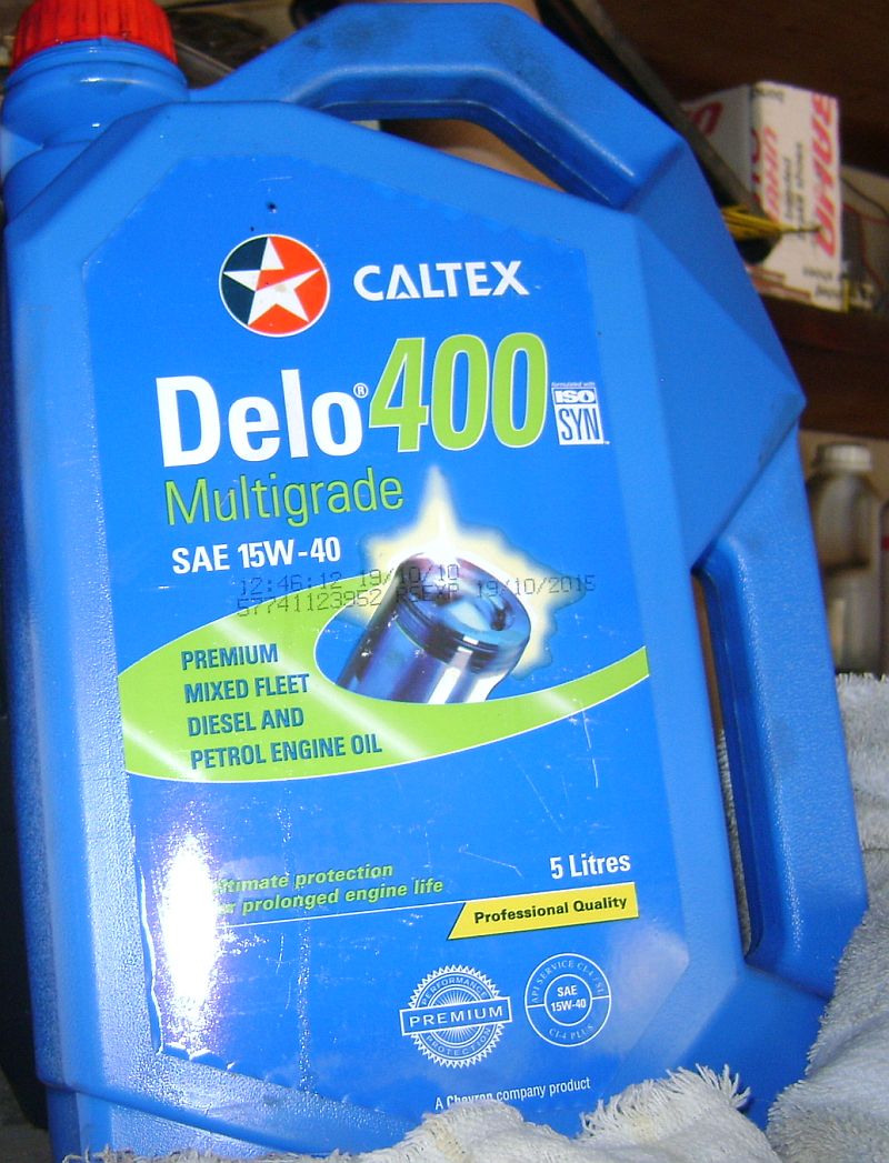

JohanV wrote:Which one do you use?
Delo 400 Multi grade or
Delo 400 Super Premium Diesel Oil ( I use this one)
Johan,
I use the same as you (Delo 400 Super Premium Diesel Oil - 15W40).
I actually thought that the 15W40 is a reference to multigrade (MULTIGRADE = An oil that has a wide viscosity or thickness range.) - therefore my understanding is that the one you (and I) use is one of the Multigrade derivatives offered by Caltex.
Maybe the lubrication fundi's here can help us out.

Hi Anton, I must confess and apologize. i am getting old and memory not that good.
I checked and i actually use the Multi grade. I remember standing with both in hand before i bought them for the service.
There doesnt seem a huge difference between them and would also like the fundies to give their opinion between the two.

JohanV wrote: Hi Anton, I must confess and apologize. i am getting old and memory not that good.
Eish - I am some 21 years older - therefore so much more "memory fatique"! :lol:
I first assumed the Delo Gold MUST be the better product, but apparently the 400 is the premium product.
I think the other Delo 400 options (eg. 10W-30) are aimed at countries with different temperature profiles. Here is a link to the derivatives: DELO 400
