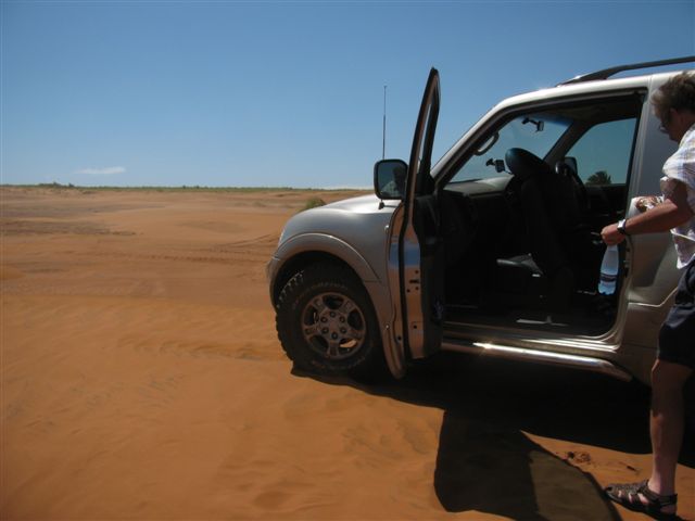

Hi All
122 days after I posted my first question on this stream I'm happy to report I have fitted the 265/75R16 BFGoodridge A/T tyres.
We went on holiday to Marina Beach and I took a day trip into the old Transkei and I am very happy with the performance of the tyres!
I had the the 285/75R16 and if compared I have noticed the following:
1. Fuel cunsumption slightly better (plus minus 4%)
2. The tyre and rim temperature has decrease a lot.
In conclusion, I am very happy with the 265/75R16 BFG's!
Nayameni - Old Transkei
