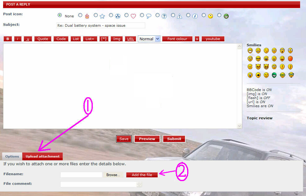

Tinus,
This is how:
1. File the pic somewhere on your PC (eg. Desktop).
2. On "Post a reply", type your message.
POST A REPLY Screen
POST A REPLY Screen
3. Upload the picture by clicking on "Upload Attachment" (no 1 ), finding your picture, and double-clicking on it. Then click on "Add the File" (no 2). The filename appears under your meassage, and you may place a comment about the file at (no 4).

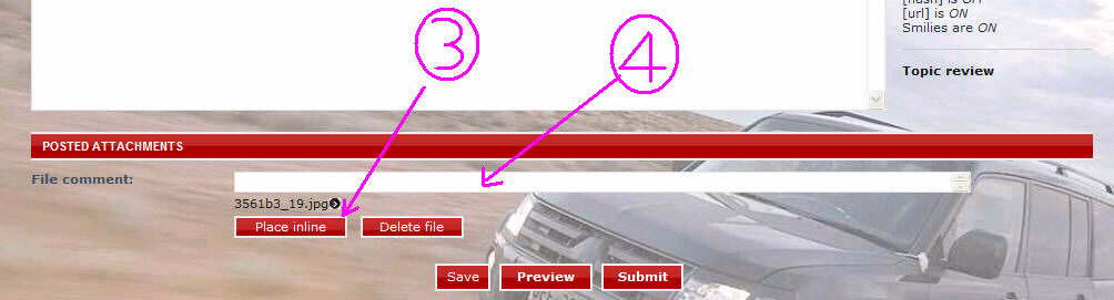

POSTED ATTACHMENTS screen
4. After placing the cursor in your message at the point where you want the picture inserted, click on "Place Inline (no 3).
Hope it helps.
