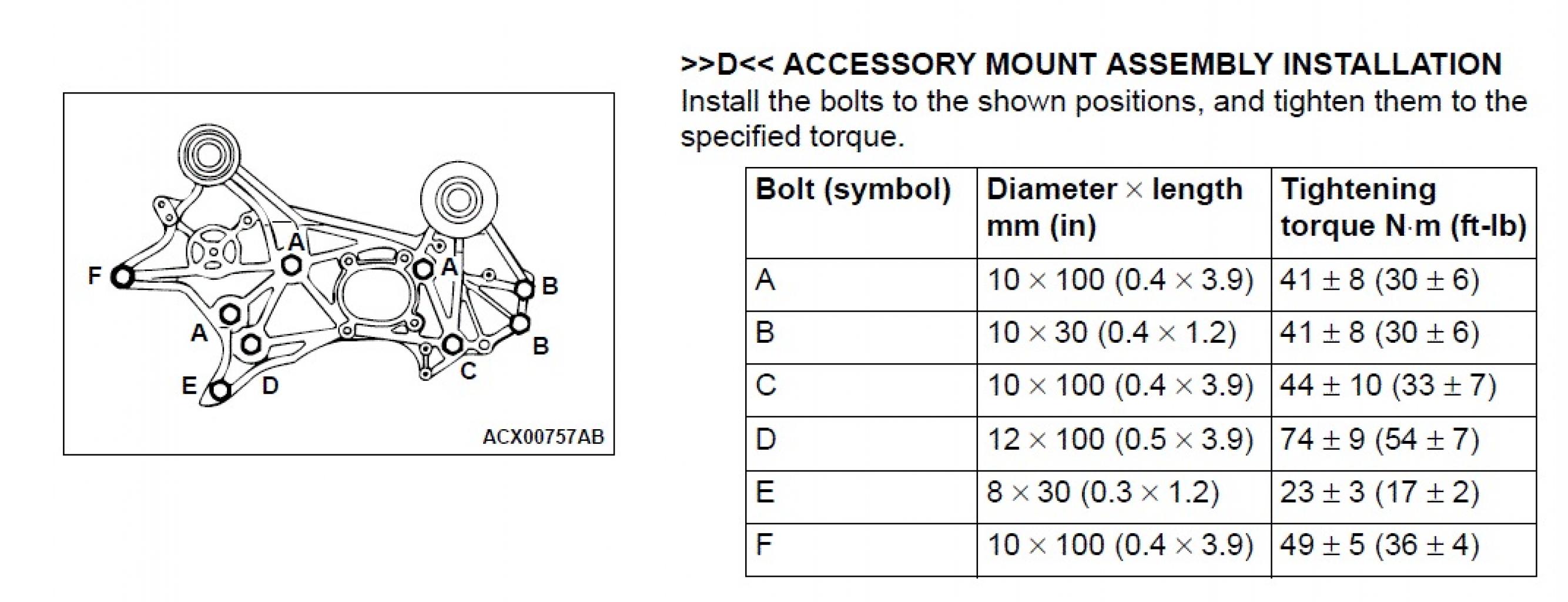

Okay. Phoned stealers, want to charge me R 52.86 each for a 100x10mm HT bolt, ex Japan and 21 working day waiting time :lol: :lol: !! Luckily I founds all the lengths and specs on the Service manual.
I will get the bolts from bolt-fast and see what condition the threads are in, I might need some time-serts or helicoils.

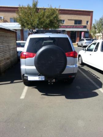

Mounted a rear spare wheel carrier

Bostokkelos wrote:Mounted a rear spare wheel carrier
Looks good! Are you installing a long range tank, or is this only for a second spare?
Looks good. Only needs a Pajero Club sparewheel cover to finish it off nicely! :)

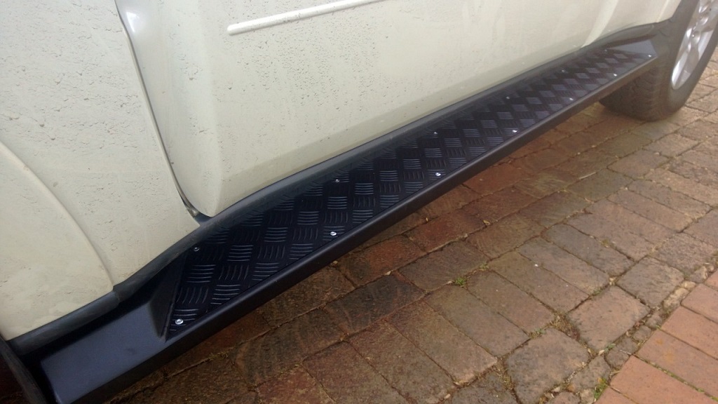

Fitted what I hope is the last of the Dev Cycle of the Stofpad 4x4 Gen 4 Rocksliders. They are superbly built and unbelievable strong! Will be testing them in Lesotho/Drakensberg this coming week!
P.S. I think he needs one more LWB test vehicle! ;)

Bateleur wrote:Fitted what I hope is the last of the Dev Cycle of the Stofpad 4x4 Gen 4 Rocksliders. They are superbly built and unbelievable strong! Will be testing them in Lesotho/Drakensberg this coming week!
How much does it cost if you are a test subject?
