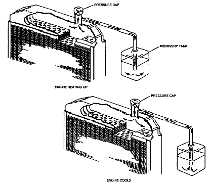

Re: Dealer p....s!
The Pajero uses a 'low pressure' system, where the expansion tank is at low (atmospheric) pressure.
Some vehicles (most German makes) use a system where the expansion tank is under high (engine) pressure.
What follows holds only for a low pressure system.
The engine block, radiator and expansion tank are supposed to form a 'closed' system.
When the engine heats up, the coolant expands. This causes the pressure in the engine block and radiator to rise.
Once the pressure reaches a specific pressure (dictated by the radiator cap), the radiator cap will open, and excess coolant will be pushed into the (low pressure) expansion tank.
(The expansion tank is called that because it retains the excessive coolant due to the expansion of coolant in the radiator and engine block).
Once the engine cools down (after shut-down), the coolant in the engine and radiator contracts. This causes a low pressure (vacuum) in the engine block and radiator.
The coolant is 'sucked' from the expansion tank into the radiator.
If coolant is pushed into the expansion tank, but is not sucked back into the radiator, there has to be a leak in the system. (Air is sucked back into the radiator, in stead of coolant ).
The culprits are usually one or more of the following:
  1. The radiator cap is defective.
  2. The pipe connecting the radiator and the expansion tank has a small leak, so that it won't suck the coolant back into the radiator, but lets air into the system.
  3. The end of the pipe connecting the radiator and expansion tank is not below the coolant level in the tank. Open the expansion tank, and confirm that the pipe is below the coolant level. Often the pipe goes only to the cap of the expansion tank, and there is a separate little pipe from the cap down into the coolant. If this second pipe is loose or cracked, it will not suck back coolant into the radiator.
Easy check is to mark levels in the expansion tank:
  1. When everything is cold
  2. When engine is at operating temp.
  3. When engine has cooled down completely again.
Levels for 1 and 3 should be the same.

Re: Dealer p....s!
Gerhard,
Your description is more eloquent and technically correct than mine, but in essence we both painted the same picture.
What has me a little worried about TC's Pajero, is the fact that so much coolant pushes into the expansion tank.
If my Datsun 1600 SSS or my dad's Valiant had pushed so much water past the radiator cap, it would have told us that something is not right with the cooling system, because every morning we would have needed to top-up with almost a litre of water. TC's Pajero is forgiving him, because it (hopefully) sucks all the coolent back into the radiator overnight. I can't help but think that his expansion tank is just about ready to over-top. The last thing I want to do is to spook TC into worrying about nothing, but we also don't want him to think all is well and then find out the hard way that it wasn't.
I checked my expansion tank this morning after an hour's to-ing and fro-ing (at more than 16L/100km) and the coolant level was spot-on the full mark. No coolent had pushed past the radiator cap into the expansion tank. We are planning to pull the heavy old Jurgens to Kruger for the weekend, I'll make a point of checking the expansion tank level after some heavy work through the mountains with the caravan in tow.
