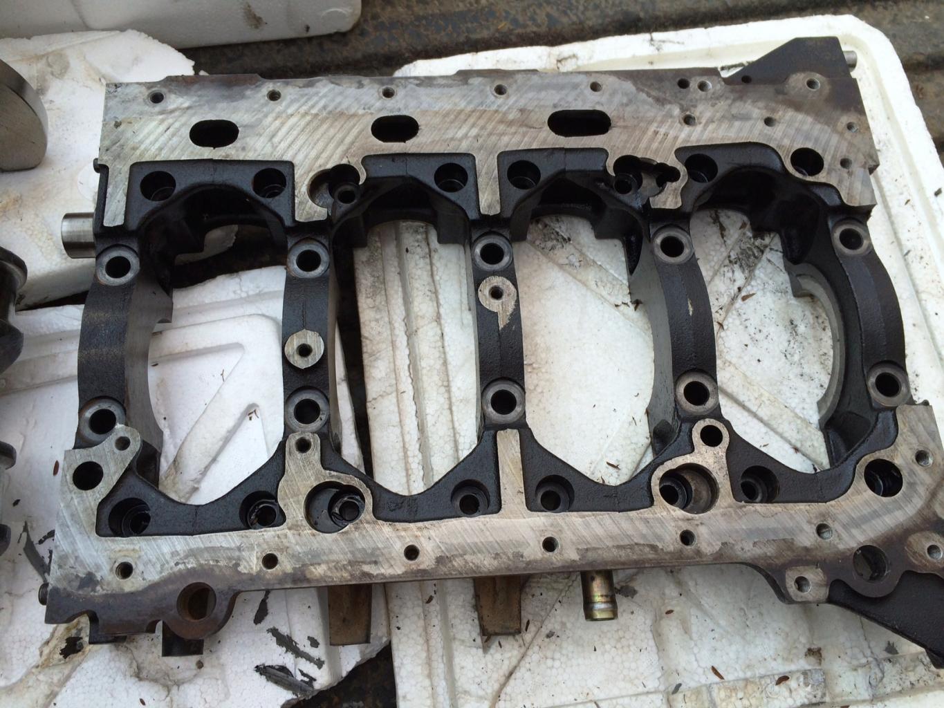

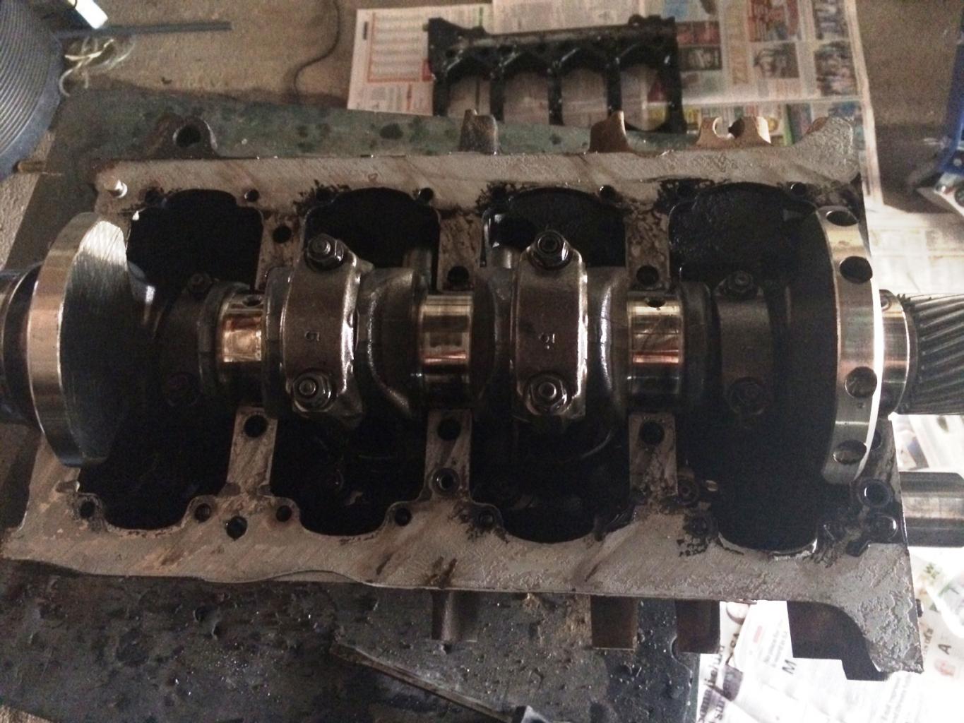

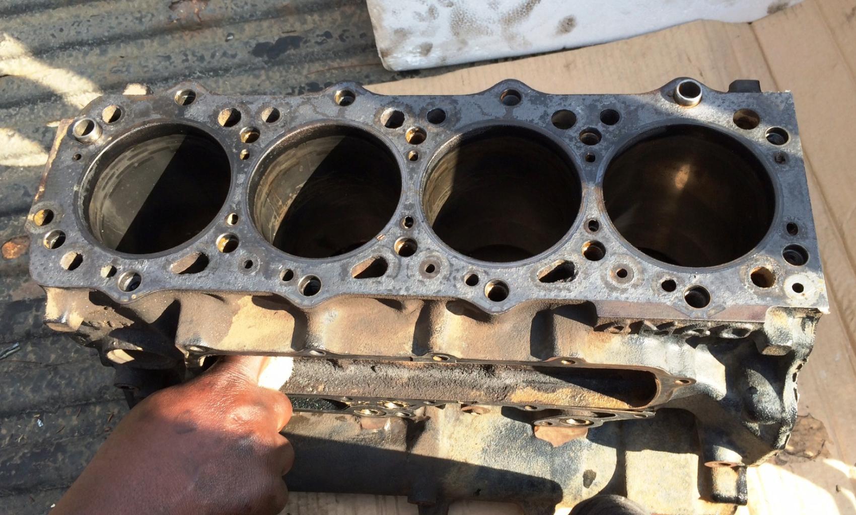

Here we have the upper engine block, lower engine block and the crank shaft.

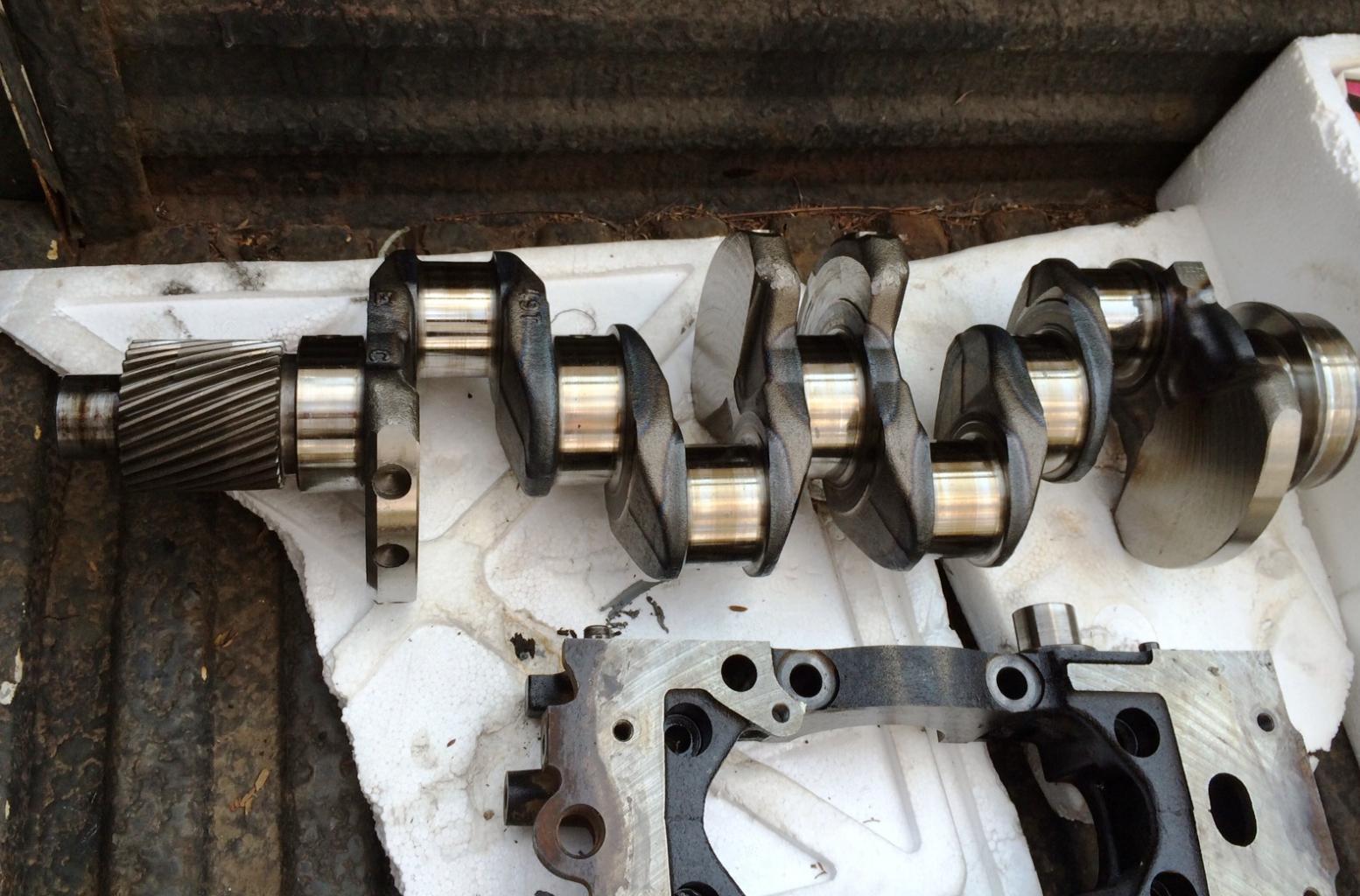

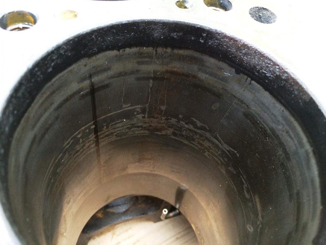

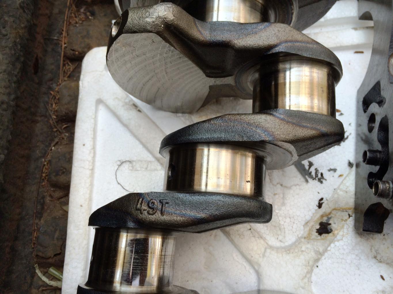

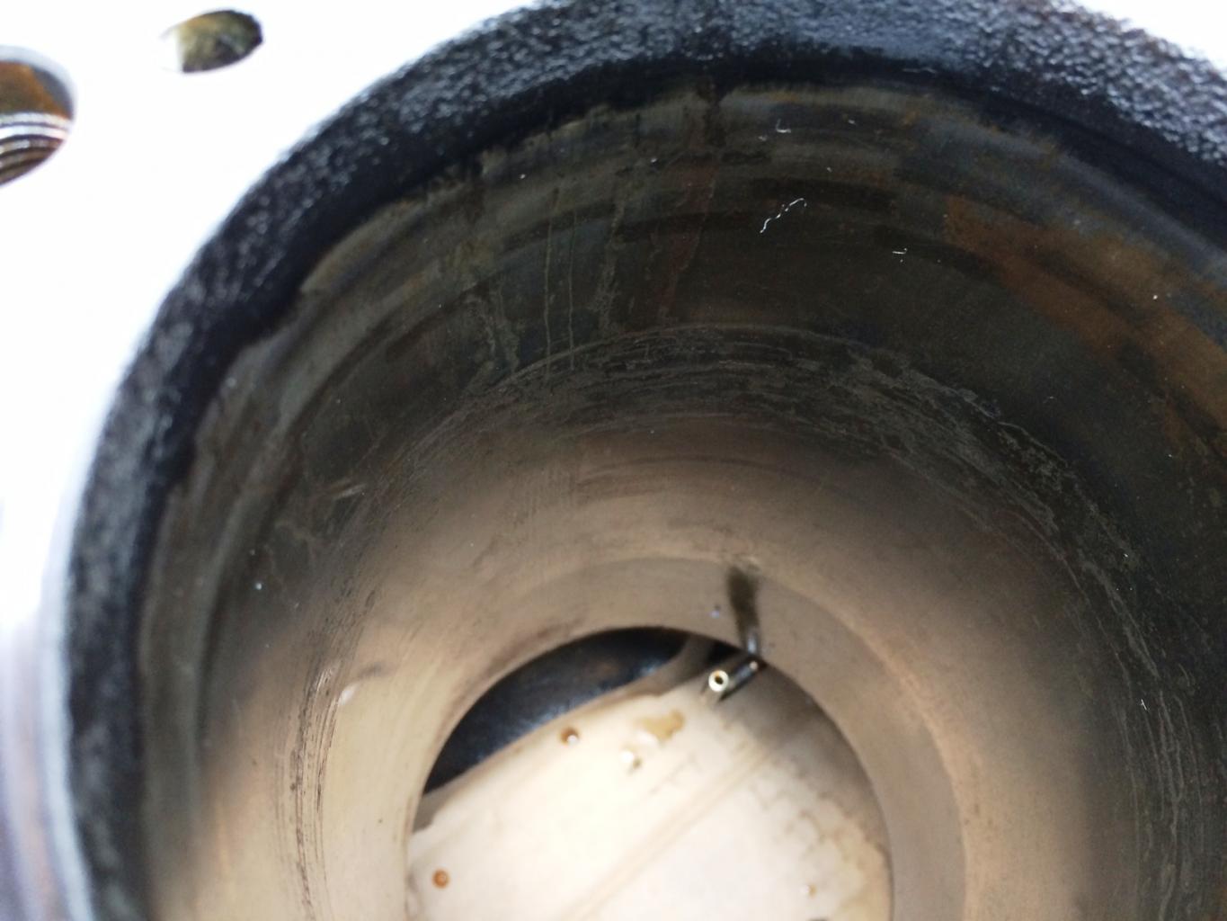

The reason for pulling the bottom part of the engine out was I was unsure of the condition of the bore and bearings etc.. These pix show the condition of he crank and cylinder sleeves/bore. The pic showing the crank journals is a little concerning to me. The journals themselves look rather promising but the heat marks on the crank is something I am not sure of. Will wait for the machinists who will check if the crank is bent or cracked and what machining is necessary.
The vertical mark on the last pic in this set is from cylinder NO3. Now that the cylinder is washed there seems to be no scored marks on the cylinder. It is possible that the cylinders might only have to be honed and not re-bored. That would be a big saving as pistons would not have to be replaces. Only rings. The middle pic is cylinder NO2.
