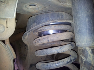

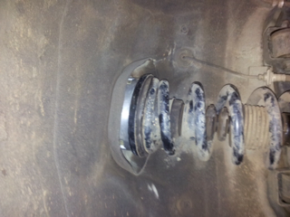

Installed Stofpad spacers! Just in time for the Barberton trip.
