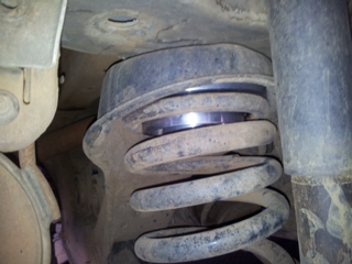

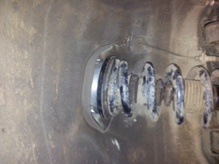

Installed Stofpad spacers! Just in time for the Barberton trip.
Sent from my mobile device using Tapatalk
