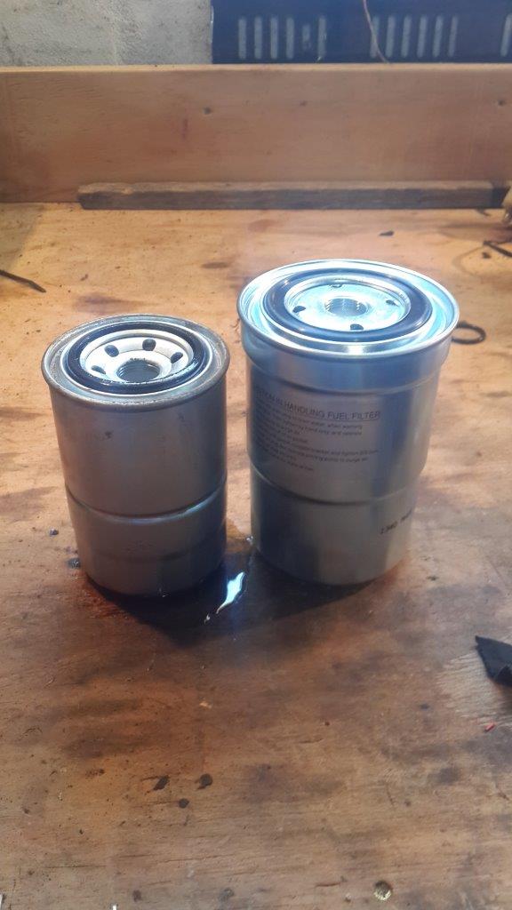

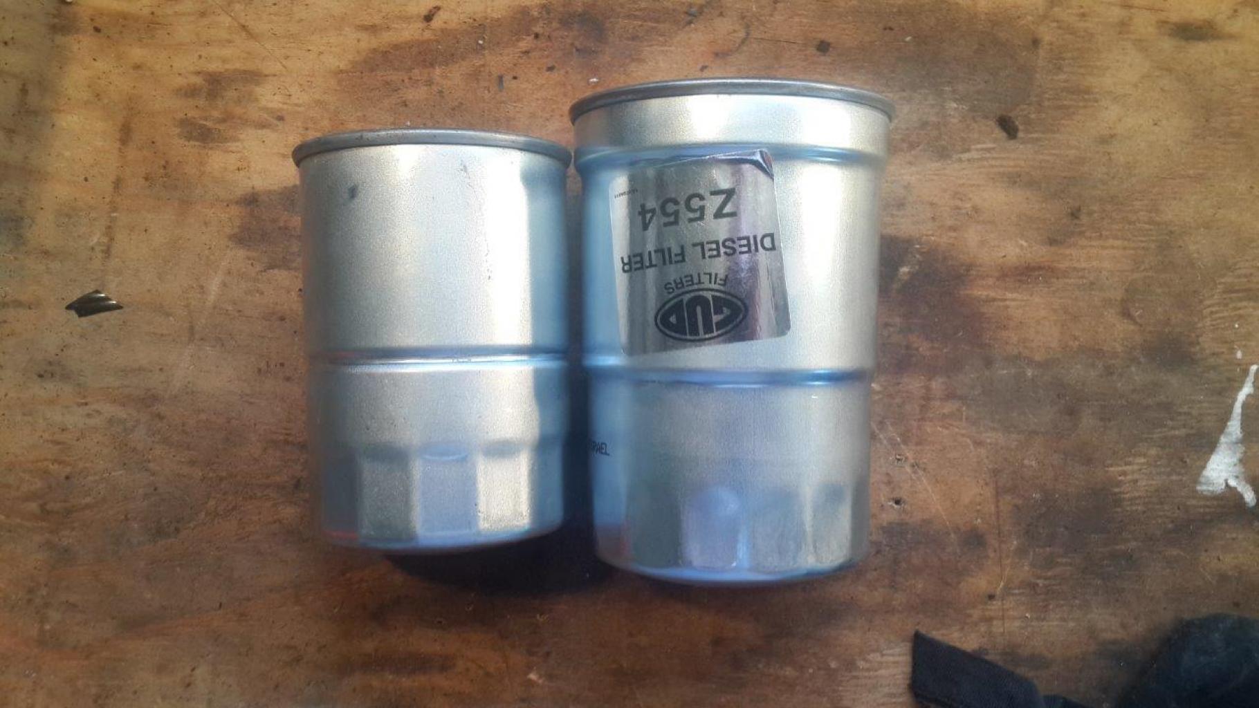

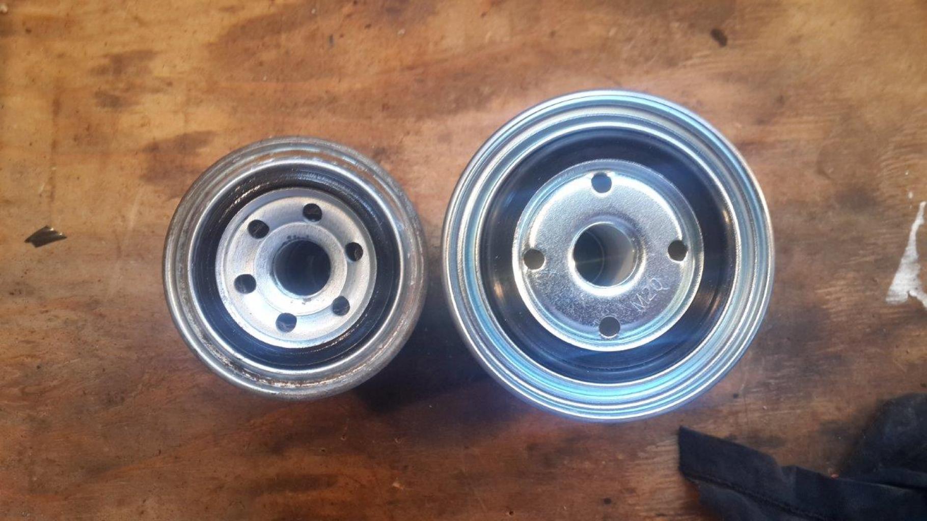

I had a bit of time to work on the Pajero on sunday.
I replaced the diesel fuel filter to try and sort out a hard hot starting issue. I was actually surprised at the size difference between the two, the GUD (made in ISRAEL nogal) being much bigger. Will see if it helps with the issue this week, the element seemed to be quite dirty.

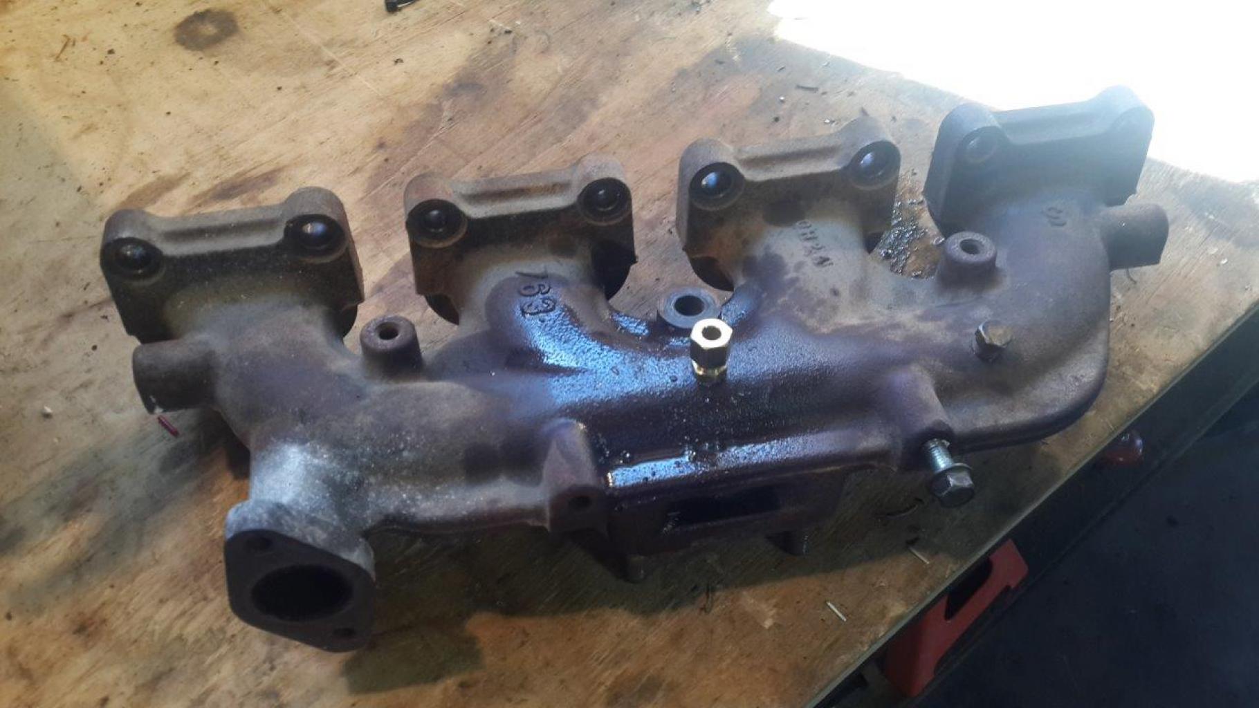

I also replaced the exhaust manifold with a well seasoned second-hand unit due to a crack in it at cylinder no. 2. I also installed a EGT probe at the same time. The manifold replacement is quite a job... The whole EGR system has to be removed, you then have to remove the downpipe of the exhaust and work your up due to the way the turbo is bolted onto the manifold. The whole turbo/manifold/dump-pipe assembly is then removed.
It took me about 3 hours to get the rusty 9 year old nuts off the exhaust and manifold (lots of penetrating oil helps), and all the coolant and oil feeds to the turbo are removed and tucked away. I then had the manifold and turbo unit out to swap the manifolds around.
Had had already drilled and tapped a 1/8" NPT thread into the 'newer' manifold for the brass gland to accept the EGT probe - from MadMan. I drilled it in a position to measure the temperature where all the exhaust gasses combine before entering the turbo.
Another 2 hours later it was all bolted together, with copaslip on all the stud threads for easier removal in the future. I will connect the probe to the MadMan later this week and start monitoring the temps.

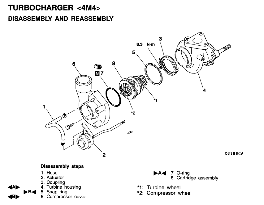

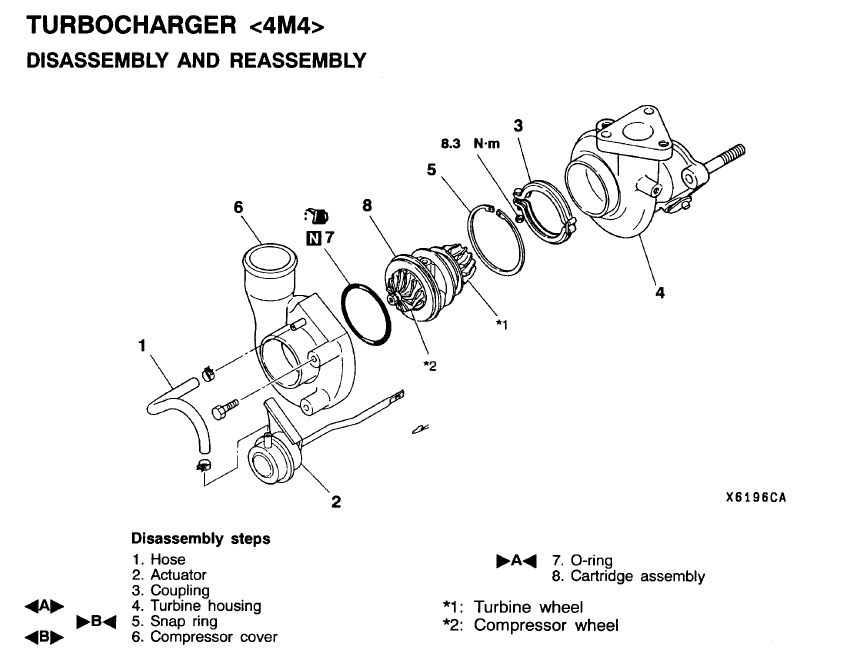

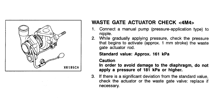

Solved my overboost CEL under hard acceleration. I first removed my airfilter box and both pipes feeding the compressor on the turbo to gain access to the pneumatic wastegate actuator can.
I previously did the 2mm wastegate spaced mod which initially caused the overboost CEL event, but unfortunately did not solve it when I removed the spacers again. I think when I fitted the spacers it pulled the actuator diaphragm into a gunked/dirty up section of the actuator jamming it slightly and preventing it from opening at 160 kPa as required.
Method to Unstick actuator:
I undid the 2 bolts holding the actuator to the turbo housing, and removed the short hose connecting it to the turbo. I then attached a longer hose to the actuator nipple and set my air compressor at 180-200 kPa (VERY NB otherwise you can rupture the diaphragm).
I then pressurised/depressurised the actuator very rapidly by blowing into the hose with the air compressor while spraying silicone aerosol spray into the hole where the actuator shaft enters the rear of the can to lubricate the innards. I did this for a good 5 minutes or so to make sure there was free movement of the diaphragm in the actuator at the required pressure - 160Kpa.
I then kept the actuator can pressurised at 180kPa, this allowed me to manually move the whole actuator assembly backwards and forwards to make sure there was no stickiness on the shaft or poppet valve (wastegate) in the turbo itself. Google - "Wastegate Wiggle"
EDIT: PLease note to only use a silicone spray or a rubber friendly lubricant, Q20,WD40 etc. has an oil base which attacks the rubber diaphragm, and will destroy it over time.
CAVEAT: Some folks say that once the silicone/lubricant spray dries out, it will cause possible issues again due to the residual stickiness. Use at your own risk.
