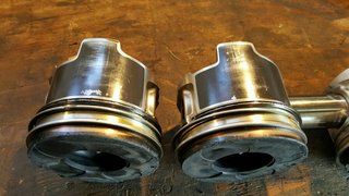

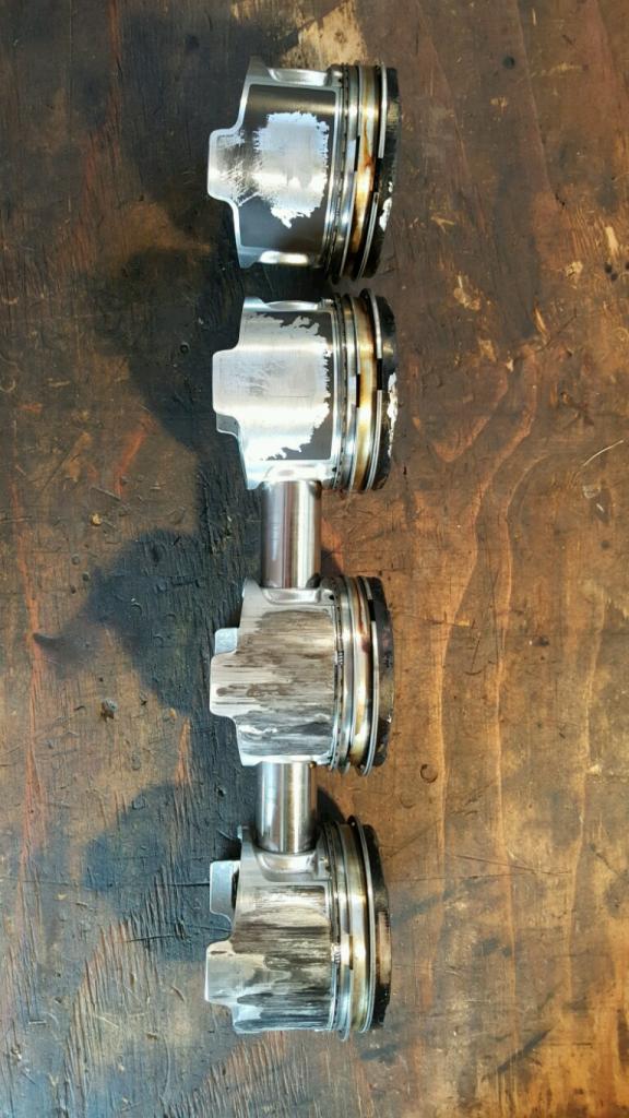

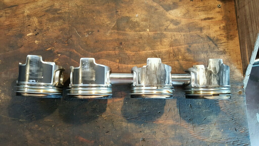

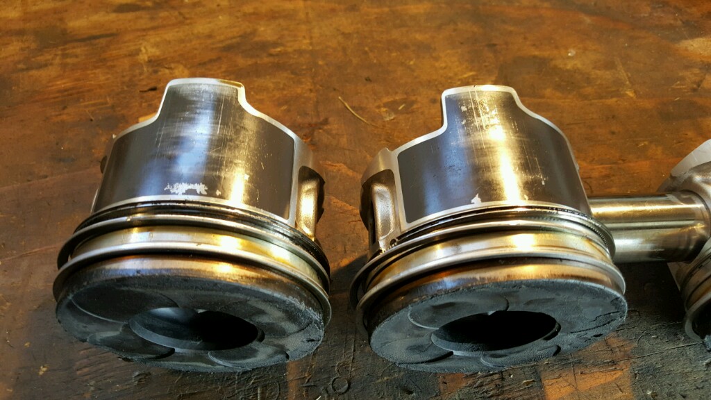

Nick Gibson wrote:Time for an update...

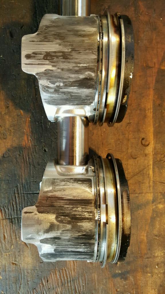

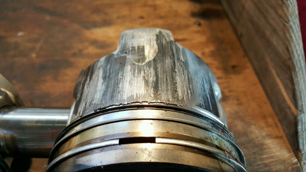

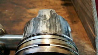

I have just rebuilt my motor for the second time last weekImage...
I had a minor piston siezure on number 1 and 2 cylinders, had to put a new piston set in and luckily the scoring on the bores wasn't so bad, I got away with a rehone of the bores.
According to the the engineering shop I had a heat siezure, basically a hot spot or airlock in the coolant around the 2 pistons which caused them to sieze and collapse. This was giving me a rapping noise in the block which turned out to be piston slap.
Will post some pictures when I am in front of my pc again.

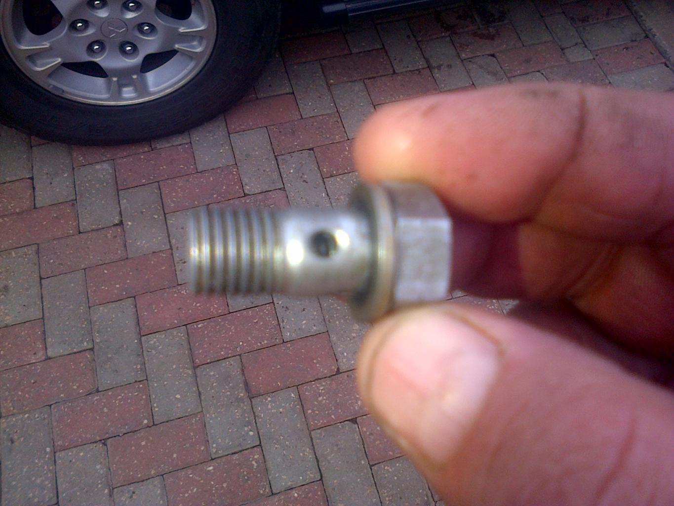

Nick, mine did exactly the same. It was also air pockets etc etc! Check the return banjo bolt on the return at the back of the pump. If the pressure in the pump can not be relieved (after shutting of your engine) through the valve it keeps on spraying the diesel through the injectors thus causing a dry oil but over filled with diesel start. There is a ball valve in there that seizes. Mine once seized after 8 kms. I replaced mine with a banjo bolt with a oriface hole and no ball valve. The guy at the diesel shop said it was a banjo bolt from a 2.8d Colt engine, it is fine now.
CasperA
Re: Pedro the Pajeros’ 4M41 engine rebuild.
This what I took out. It is located at the back of the fuel pump above the injector pipe nipples. There is two pipes coming out of the banjo.

Thanks casper. I will have a look at that bolt, I know the one you are referring too. I am interested in your rebuilds, what happened that you had to do 5?
When I stripped mine down everything was perfect, just a stupid airlock caused my engine siezure.
4000km on these pistons.

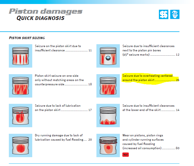

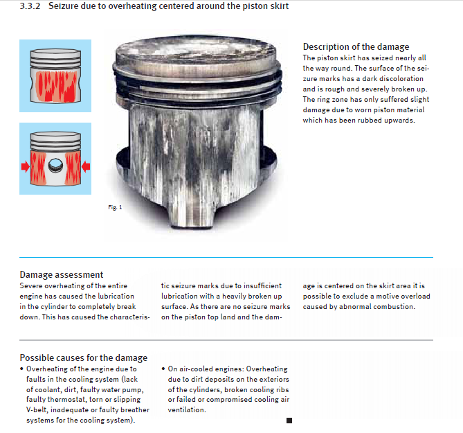

Ok here is more reading on the damage I had on my pistons.
Here is the reference page with typical damage, I ruled out all others, the only one it matched was the piston skirt damage due to overheating.
Piston Damage
Piston Damage
Reference page
Piston Damage 2
Piston Damage 2
Symptoms and possible causes.
piston_damage.pdf
(3.08 MiB) Downloaded 380 times
Document.

Retrospect:
Looking back, I recon I did the initial piston damage at about 150km into the first running in process, when I took the car to work the first time. I was just picking up speed on the highway when she lost power and stalled - CEL came on. I coasted to the side of the highway and had a look at the engine bay, couldn't see anything wrong (oil, water leaks, etc) or any funny smells. I cautiously attempted a re-start and she caught first swing - must have been an airlock in the fuel system - or so I thought...
Ever since then I heard a light tapping noise at startup - similar to a noisy lifter on a V6 until the oil pressure builds up. At first it was only at startup and went away, then got progressively worse until it was doing it the whole time while driving, also with occasional bouts of of blue smoke until warmed up. When that happened I decided to pull the engine tear down and see what was wrong - I though small-ends bearing - but the blue smoke was puzzling me. In the end, it turned out to be piston slap due to the over-heat and resultant collapse of the pistons.
Suspected cause:
Steam pocket or airlock/hotspot due to lack of coolant. Possible coolant bleeding issue?
Initial rebuild bleeding of coolant.
Before the first start last year, I slowly filled up the coolant via the radiator cap, and stopping often to 'burp' the system by pumping the upper and lower coolant hoses. Once brimmed I left it to idle the engine warm while checking the coolant level with the cap off. I must have missed something along the way, perhaps in one of the heater matrix, as I did not switch these on.
