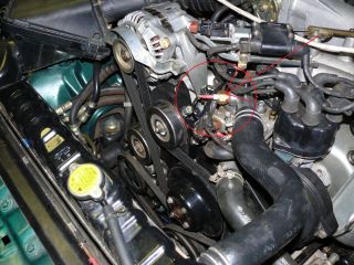

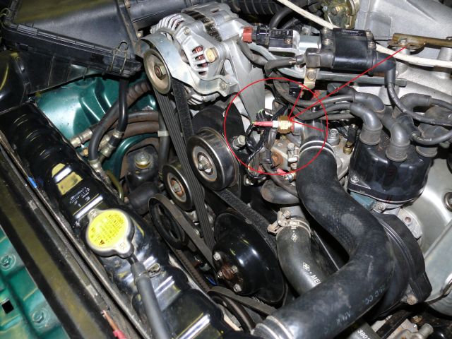

I have scoured through the workshop manual and there is a A/C temp switch on the thermostat flange that breaks continuity at approximately 112 - 118 degrees celsius......
.......which I can utilise with a 5pin standard automotive relay.
