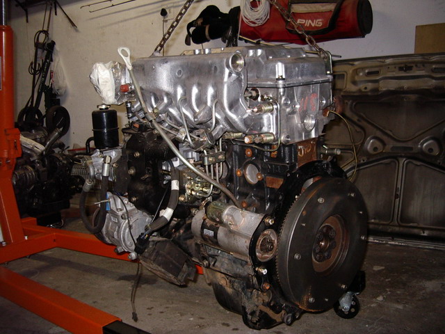

The flywheel/clutch combination from a 4M40 (2.8 TD) is a direct bolt-on at less than half the price. The increased vibration is negligible IMHO.
Replace the release bearing, crank seal, gearbox input shaft seal & clutch cylinder seals with the saved money while you are in there.
What Marius said.
Try Parthunt in Pretoria for a flywheel.
Just be aware that there are two diameter flywheels available for the 4m4* engines.
If you change size, you will need the correct mounting plate (between bell housing and engine) as well.
The dual mass flywheel is a "nice-to-have".
I have the solid (off a 4m40) flywheel and clutch, which is as smooth as anything I've driven.

Hi .Have not seen that particular flywheel but have replaced numerous toyota (3l /5l/ 1kz) two piece flywheels.There flywheel contains a heavy duty clutch and torque coil springs designed to take the whip out of the drivetrain at lower speeds.The flywheel isnt serviceable.An aftermarket one piece flywheel and suitable clutch kit is available here.Maybe something like that is an option for you
Thanks Marius. We eventually had a solid unit built. As strong as a truck. IS Parthunt useful for other components e.g. brake discs, engine/gearbox mountings?4ePajero wrote:What Marius said.
thanks Digger. Just curious, at what kind of price?digger wrote:Hi .Have not seen that particular flywheel but have replaced numerous toyota (3l /5l/ 1kz) two piece flywheels.There flywheel contains a heavy duty clutch and torque coil springs designed to take the whip out of the drivetrain at lower speeds.The flywheel isnt serviceable.An aftermarket one piece flywheel and suitable clutch kit is available here.Maybe something like that is an option for you
