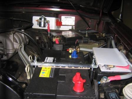

After much reading (Thank you for all the people I have been in contact for advice, by far too many to mention) the various forums and internet and the 4x4 shops (NL, etc.), I decided on the following;
1 Semi Deep Cycle "Deltec"
2 4 way Switch - Seaworld - to switch electrics off/ system operate on Batt 1/ System operate on Batt 2 or Both batteries
3 Cole Heresee Solenoid Relay
4 30A Relay protected with a Diode - as a latching circuit
5 35mm2 Welding Cable (approx 5m) plus lugs and soldering
6 2off 100A fuses (of which the wire was removed and modified to fit 35mm2 W Cable)
7 Cole Heresee Push Start (Manual Override)
8 Timer Relay
9 Low Voltage warning with LED and Piezzo Buzzer per Battery (Settings: Batt 1@ 75% & Battery 2@50%)

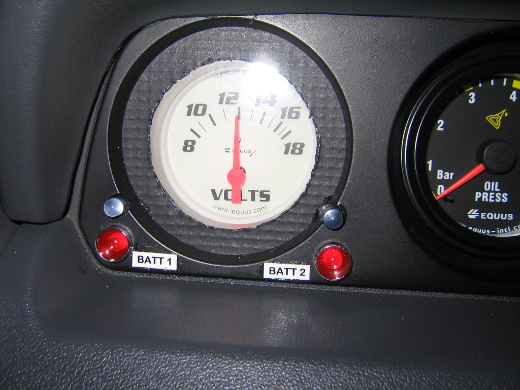

10 Equus Volt Gauge with toggle switch and individual blue LED to indicate which battery is being monitored
12 Six Fuse Box with a 40A relay that will isolate all loads (fridge, two way radios, camp lights,etc.) from Batt 2 on low Voltage
My system allows me to "automatically" charge Batt 2 but with a manual override if the timer plays up. Its nice to be able to have the flexibility to use the batteries between the primary circuit - start, lights, a/c, etc. and secondary circuit - fridge, two way radios, camp lights,etc. or together - jump start and or winching
The last of the cables are being installed as well as the last low voltage board is being put together
