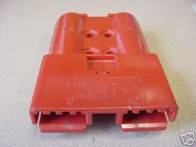

Is this the one?

- the BH plug has a hole through which you can fit a screw / bolt to fit it to any flat surface.

- the orange plug in tonton's post has a Amp rating much higher than what you need (I think 100A). You need the grey plugs
