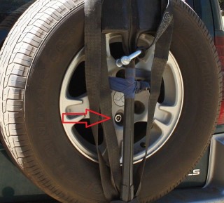

The Gen3 doesnt use wheel locks lug nuts. The key reffed to is the same key you use to start the engine. as seen in the first picture of my dad's pajero
Missing Attachment
When i purchased mine the previous owner have removed the original Key lock and replaced it with the lug nut lock as seen in the second pic
replacement
replacement

I am afraid to say but you only option if some "spook pipi" to try and remove old dirt or the correct key dont work, you will have to butcher that thing to get it off.
