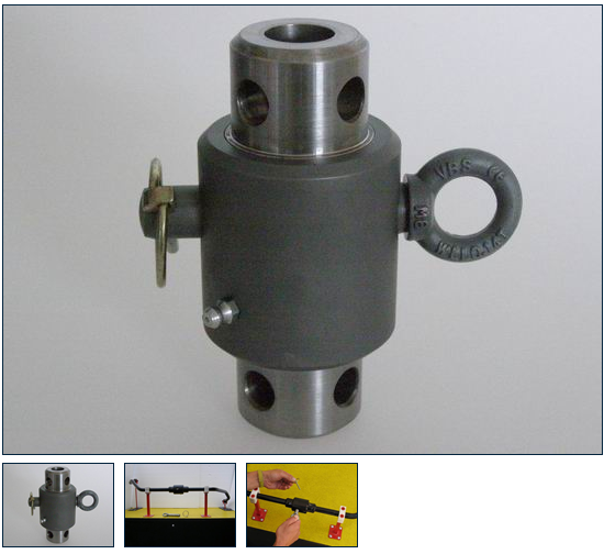

RoelfleRoux wrote: Some offroad challange boffs remove their anti-rollbars for the challange.
And some of us are getting quick disconnects manufactured :lol:

RoelfleRoux wrote:Simon,
That is rather clever.
Would that be front and rear?
Are they in the process of being made or fitted already?
Would that be Gen 2 or Gen 3 as well?
Roelf
I can't say too much but there are manufacturing license discussions on the go with the crowd in Europe that invented them. For both front and rear
They look something like this, and require the sway bar to be cut in half.
Sway Bar Quick Disconnects
