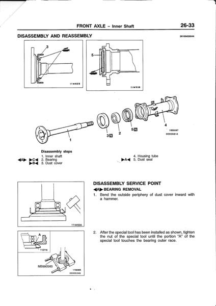

The Idler and Pitman Arms were fine and needed no replacement. While stripping we found the result of the wobble. A bearing on the right front inner shaft has disintegrated. Basically because the dustcover was not fitted properly and came loose and exposong the bearing. This according to the workshop manager. Mitsu does sell these as seperate parts and hopelfully this will be delivered this afternoon as promised.
Inner dust seal (5) R 41.00
Bearing (2) R 105.00
Outer Dust Cover (3) R 31.00

I'm possibly going to be able to add to this thread. Doing the front right inner CV boot today I discovered what looks like my front right inner shaft bearing failed/is failing.
Part numbers
MR446902 for the complete kit
MB160662 for the bearing only
MB160948 for the dust boot only
Will phone for some prices tomorrow.
At least I'm familiar with the disassembly of how to get to it.
Part numbers

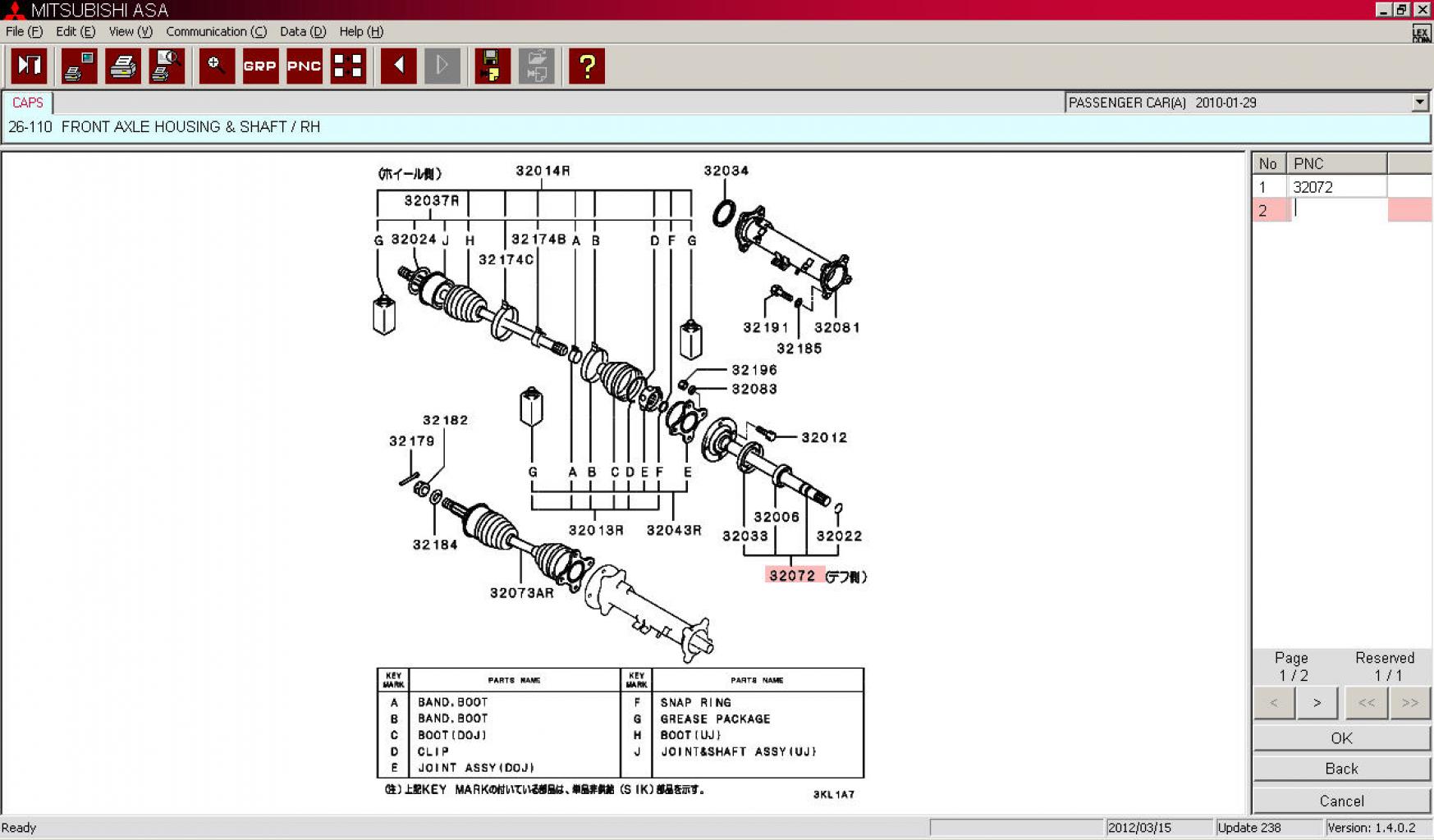

MR446902 - R7280
MR160662 - R93
MR160948 - R30
Prices are excl vat
MR160662 - R93
MR160948 - R30
Prices are excl vat
"MR446902 - R7280"
ouch that is rather steep. what does that consist of?
I suspect that's the whole assembly with shaft, flange, bearing and dust caps altogether.Transkeicowboy wrote:"MR446902 - R7280"
so that would be R8300 per side for the parts....geesh not something you want to have to do too often that is for sure!
