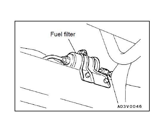

bolted to one of the chassis rails towards the rear of the car. Yes you have wriggle underneath the car to get to it.
Hi, I have crawled the length of the car on both sides following the chassis rails and although I see the fuel lines I see no filter. Weird
Thanks SimonB, That is what i imagined it should look like - but it is not there? I have had a number of differences with this particular Pajero. (Jap Import). For instance my front wheel bearings are the double wheel bearing and not the cheaper ones that you get on the Sa versions also my Air Filter is a large panel filter appraently also different to the SA one. I cannot believe I cannot find this fuel filter. Thanks for your assistance anyway.
