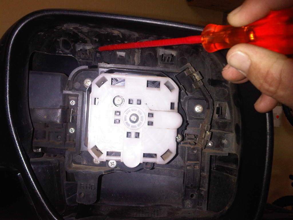

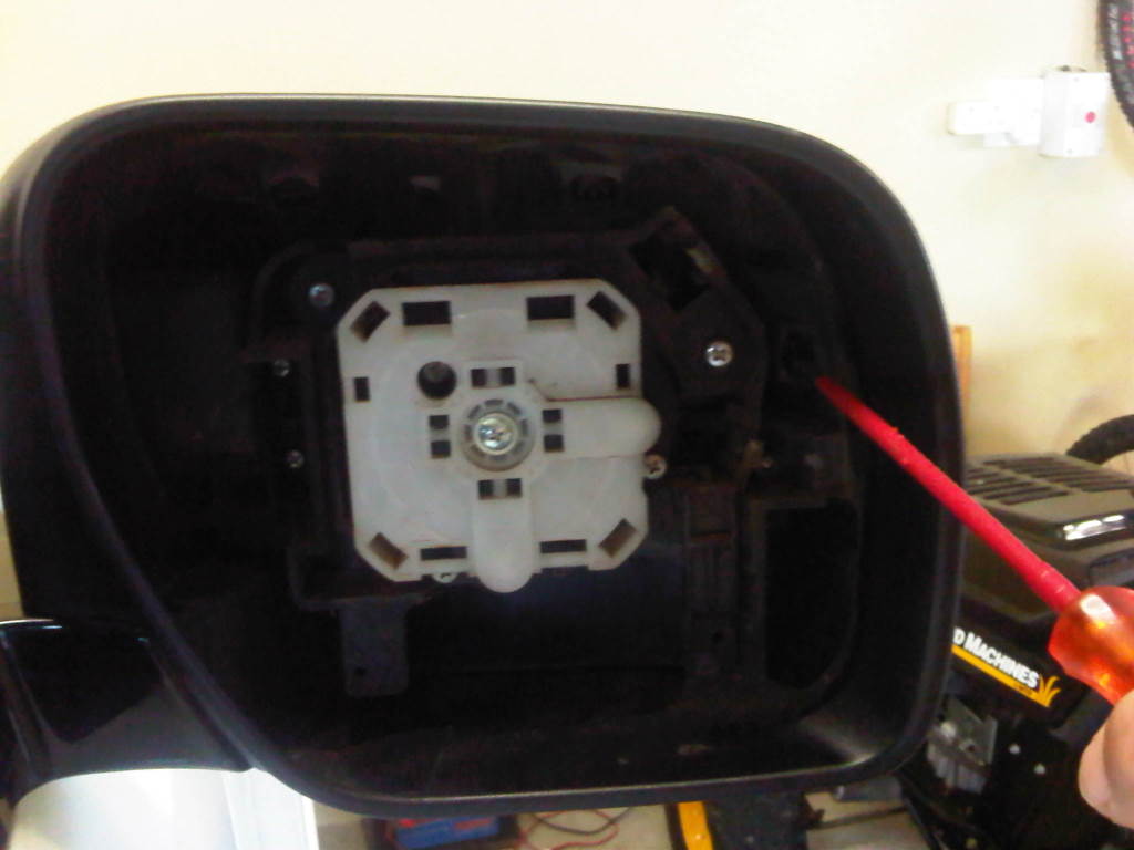

Its a simple thing, took me not even 5 minutes. The stealers wanted to replace the whole thing :?
Attached is the procedure to remove the mirror. What it doesnt tell you is be prepared cause it really pops out.... Lucky I managed to catch it.
The rattling comes from the "front or forward facing top cover" It has some clips on the inside (see clips pic) that I couldnt get loose. So, I glued it vas:):):)
Four spots of Pratley clear and pop the mirror back in. SORTED :mrgreen:
Also, a big thanks to the Ozzi guys for the destruction manual ;)

another clip also glued.
Clips now glued
Clips now glued
