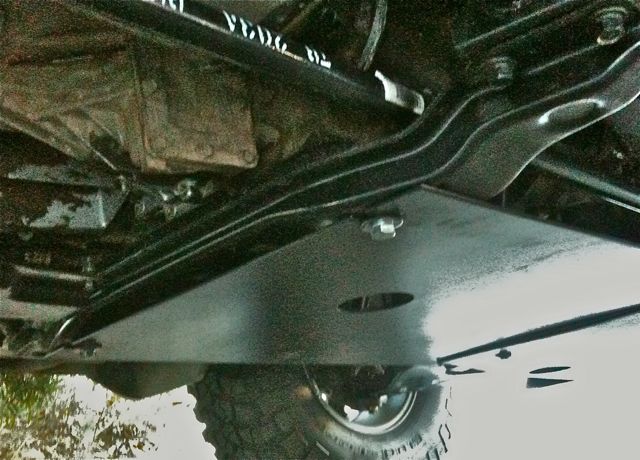

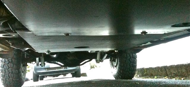

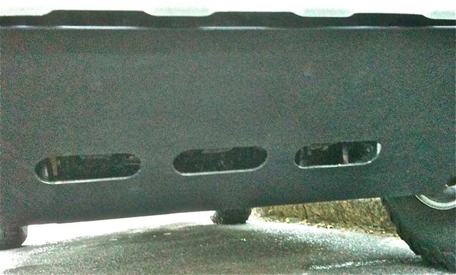

Just some pics of the "two piece" bash plate make up, you're contemplating.......'till 2nd crossmember
I personally don't think this is a very good design as regards the mountings. The potential for having those bolts shear off is high. I would have had the fitters weld a flat ring around the mounting holes at least as high as the head of the bolt. This would protect the bolt head from sideways impact
