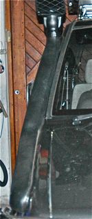

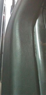

Would like to see the Gen 2 (before the blister fender) snorkel installation under the bonnet please?
I am installing the same snorkel and would like to see how the install was done at the airbox...
Re: Snorkels, yes or no?
Hi David
I hope these photos help a bit.....had mine (Gen 2 ) done recently, but still want to do my Blister Fender 3.5 V6, as well as all the diffs and boxes..... on BOTH :shock:
Picked up contaminated oil in the diffs on more than one occasion :o :o
I can take more photos of the inside of the engine compartment, if you require?
