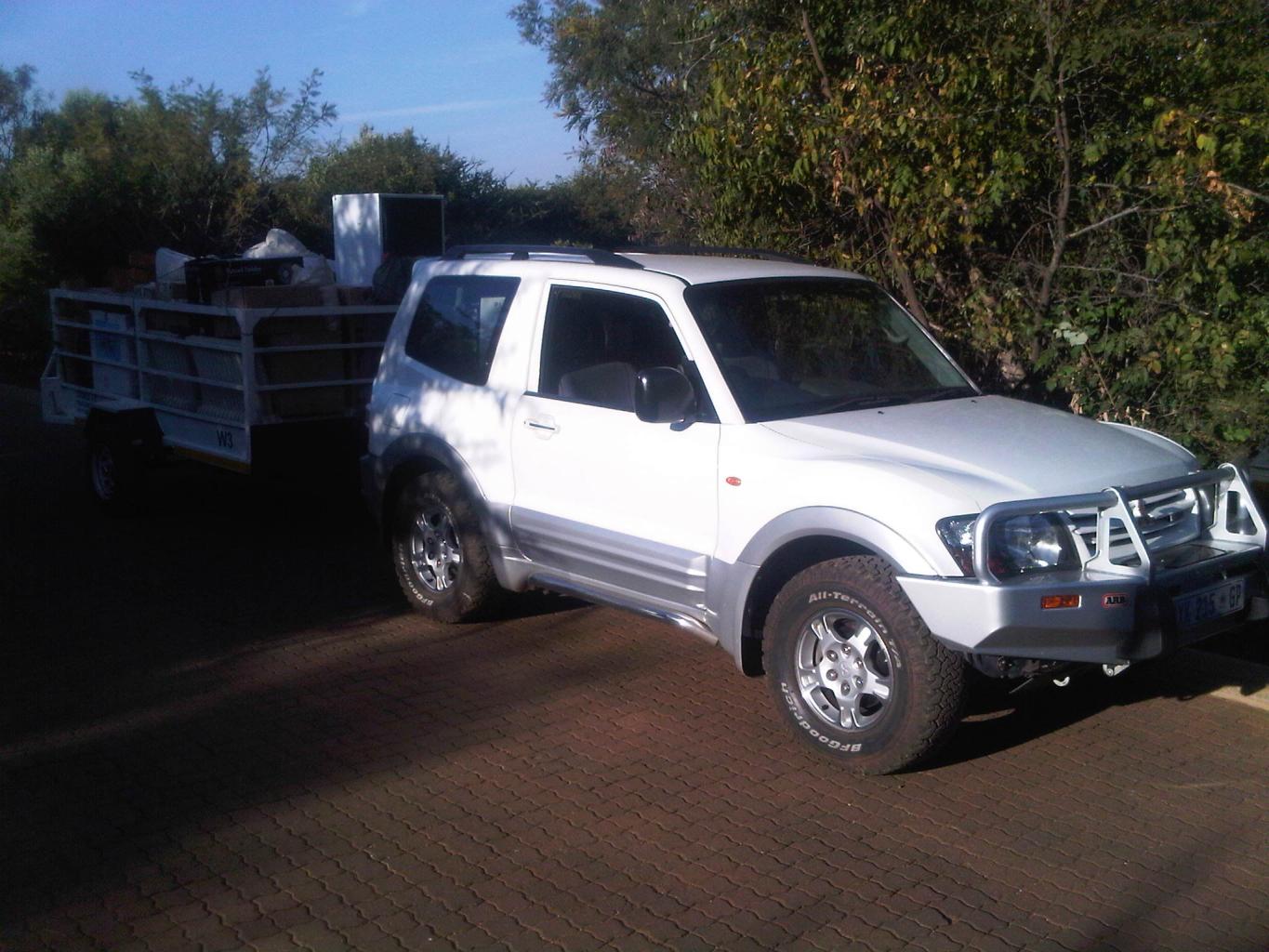

My 3.2did manual has done its fair share of towing horse boxes, odd Conquerer trailer and just recently a 1ton + loaded trailer from Pilansberg to Jhb and I was again amazed at the ease of the engine, 100-120km/h in 5th, coasting on cruize control, no strain at all, if I wanted to accelerate past a slower vehicle, no questions asked.
Past Harties up the long hills past Lesedi Cultural Village, used 4th and cruize control kept 90km/h, and still so easy.
Even slowing down to 60 for slower cars, resuming back to 90 was effortless.
Brakes on the vehicle is excellent when bringing a heavy load to a hault.
I really enjoy towing with this shorty.
