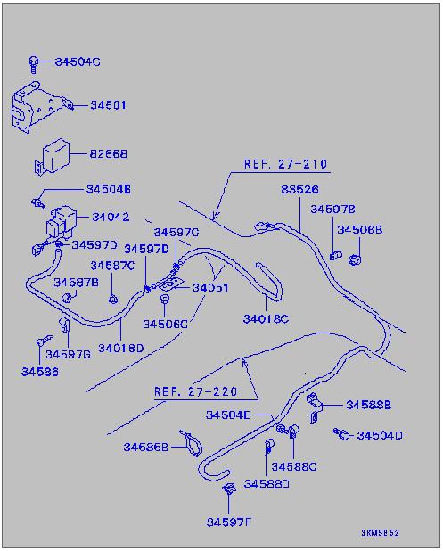

I checked WinCaps, and found the following:
I assume you have type V46W pajero, but if you send me your VIN no, I can confirm.
MB664381 - AIR PUMP, RR DIFF LOC
The control unit can be one of many, see the attached PDF file.
DIFF CONTROL UNIT.pdf
(114.08 KiB) Downloaded 407 times
