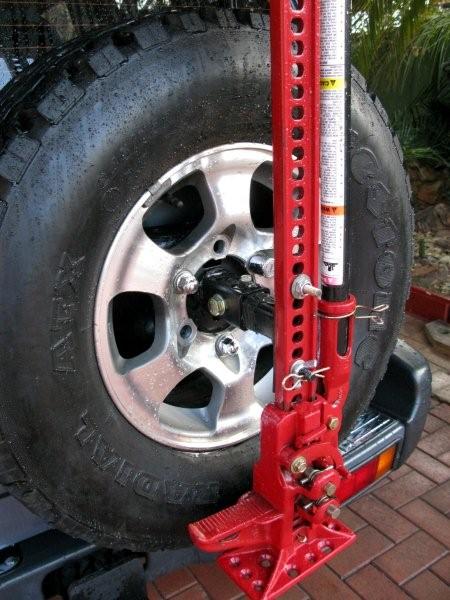

Regarding the weight on the door. I have a bicycle carrier which straps to the spare wheel. I have carried two bikes on the back extensively over rough terrain and there's absolutely no sign of any issues. Two bikes plus the carrier are considerably heavier than your High Lift jack.

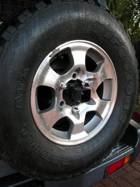

anyway i mounted the jack bracket on the rear spare wheel bracket. must say it looks the business. i still felt a unsure about all the splt pins holding the jack on,so i am in the process of modifying all the pins to nuts and bolts.
i am also going to put bolts through the spare wheel bracket so that the wheel is easier to put on. at the moment you have to hold the spare wheel with one hand,line it up and try and bolt it in place with the other.

here is a pic, i have since shortened the bracket so the jack fits closer to the wheel.

If thats's the case you're missing the small hanger on your spare wheel bracket. This "hanger' (for want of a better word) allows you to lift the wheel into place and it can carry the weight of the wheel while you line the holes up. If my petite wife can put the spare back, anyone can.steve wrote: i am also going to put bolts through the spare wheel bracket so that the wheel is easier to put on. at the moment you have to hold the spare wheel with one hand,line it up and try and bolt it in place with the other.

aaha, just spotted that small hanger now. seems it was tucked away with the spring all gummed up from dirt and dust.
