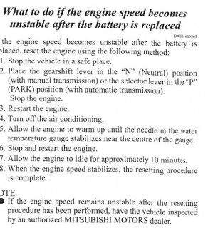

If you disconnect the battery, you will have to recalibrate the electronic compass (drive in circles).
The engine idle speed can also become irregular after disconnecting the battery - it has happened to me more than once, when disconnecting the battery. If you don't, you'll notice that the idle jumps around, and it can be a problem, if you are in "drive" and standing still - the car can try to lurch forward :)
You need to follow this procedure:
Reset Idle
Reset Idle
