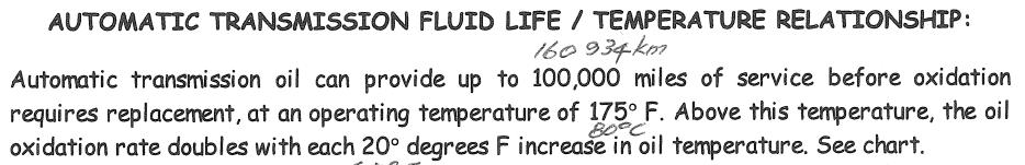

Interesting.
From the document:
What the heck do they then use in my Touareg's auto box? :?
It is an Aisin product,
sealed for life!
One cannot even check the ATF level, never mind top it up or re-fill with fresh oil! :o

4ePajero wrote:What the heck do they then use in my Touareg's auto box?
Perhaps VW think the power is enough so you will not over-stess the transmission :)
OR
VW know that Tauregs are mostly used on the tar roads in Sandton :) :D :lol: :D :)

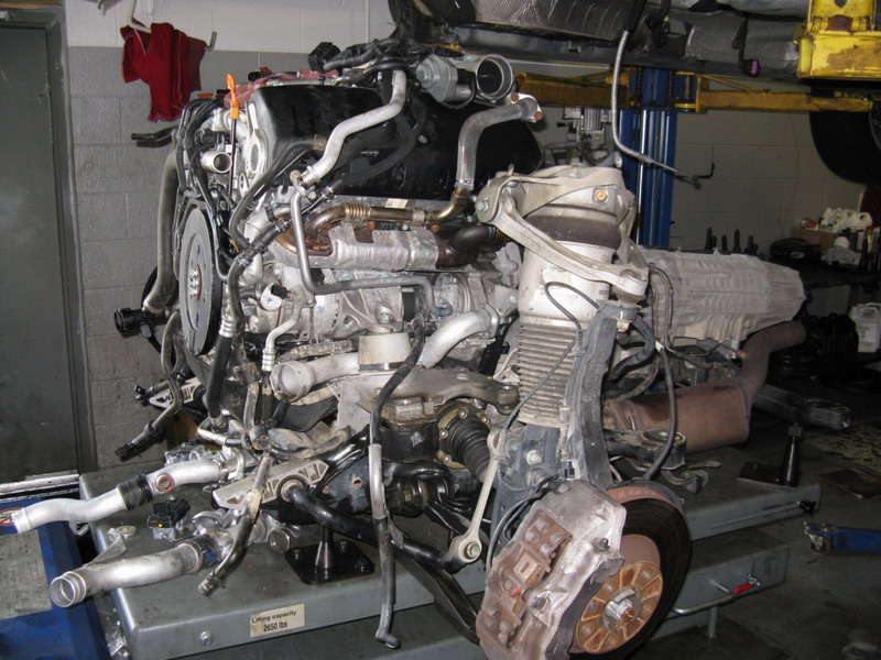

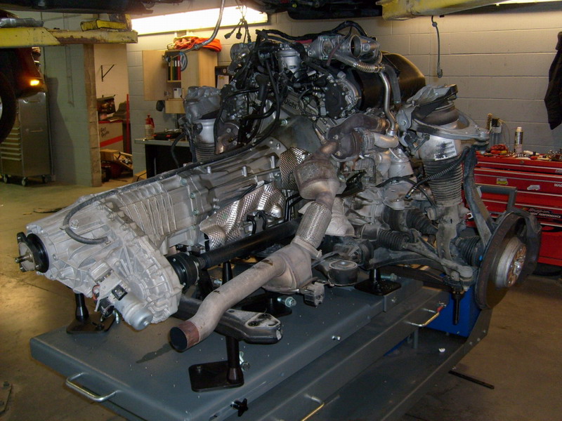

The V10 engine is no more complex than the Di-D engine.
The 'problem' with the V10 TDi engine is that the beast fills the engine compartment fully.
Any work on the engine starts with "Remove Engine and Transmission" :!:
The agents has a special trolley to make this possible, but the cost of "remove ... refit" most probably made the insurers opt for the "scrap" option. Most probably nobody wanted to accept responsibility for the removal for inspection.
Apparently the removal 9with the trolley) is actually easy.
Having done a few things on the V10 Touareg, I am convinced that, once you have the engine out, it is not impossible or even more difficult than other engines to work on (definitely easier than a R5 Renault or (old) Mini :D )
The heads come off with ordinary tools (although you will need Torque type sockets, which VW/Audi just love!)
There are agents who really know the Touareg well (eg Tavcor in PE), who will get my business if really required.

are those boost or coolant pipes? I can't make out as they look small for boost pipes and massive for coolant pipes....
Maybe boost pipes as there are 2 intercoolers for each bank/turbo???
