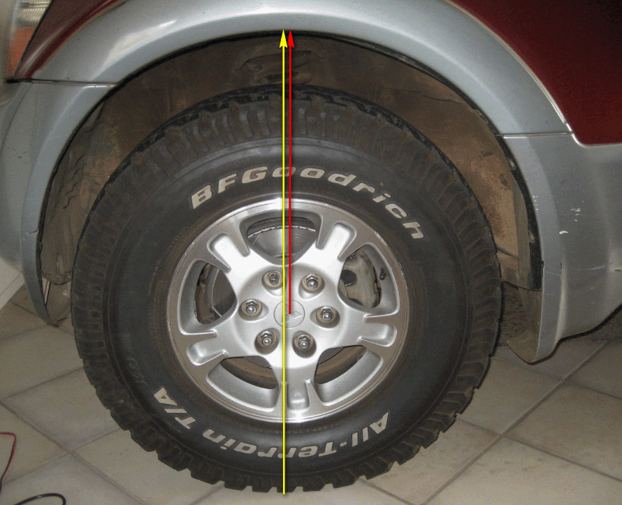

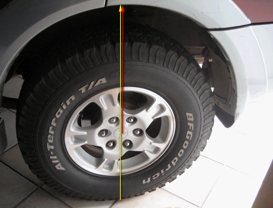

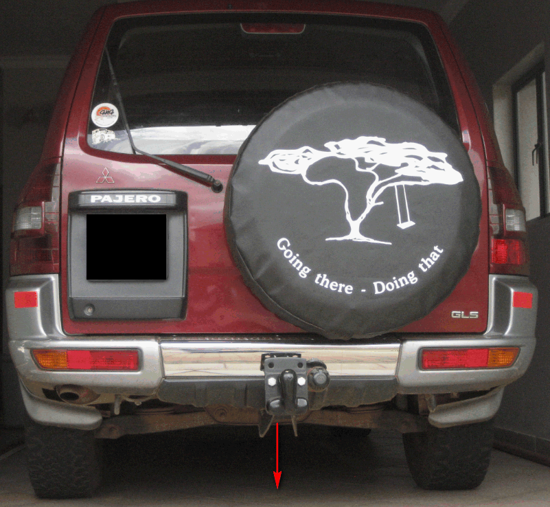

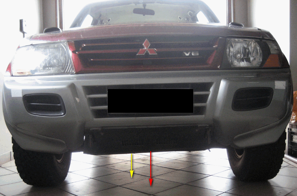

I decided to take some measurements before I get my bullbar added on Monday, found some interesting results too. Looks like it is clearly higher on 1 side than the other by between 13 and 17mm.
At the moment my Pajero has 138,000km's more or less on the original suspension, I have gone up 1 size on the tyres from 265/70/16 to 265/75/16. I have also noticed that one of the lowest points on my Pajero is just before the cross member up front, where my second bash plate ends and also where I have sustained the most dings to my bashplate (some serious dings I might add) (in standard form this is plastic, so best watch this spot). I have attached a few pics of the measurements which is before the bumper is fitted and will again after the bumper is fitted, dual battery installed in engine bay and again when I have the spacers fitted or coils (jury not out yet on this one) to get a bit of history around these changes.
Would be nice to have some comparisons from other Pajeros, just noting whether standard or any modifications. I am assuming that the variance can be due to sagging and may well mean considering replacing the coils (see this thread - https://www.pajeroclub.co.za/forum/view ... =28&t=3009 )
The pics indicate the measurement locations as I took them.

David,
I measured the height of my Pajero as per your third and forth photos - that is from the centre of the wheel arches and the measurements are as follow:
front - 88cm and rear - 89cm. That is with my extra fuel tank with about 15lit petrol in it and my drawer system installed. Also keep in mind that I did a body lift on my Pajero -
front = 50mm and rear + 30mm. So if I can say in standard form the heights on my Pajero should be ± 83cm and 86cm.
Cloyd.
