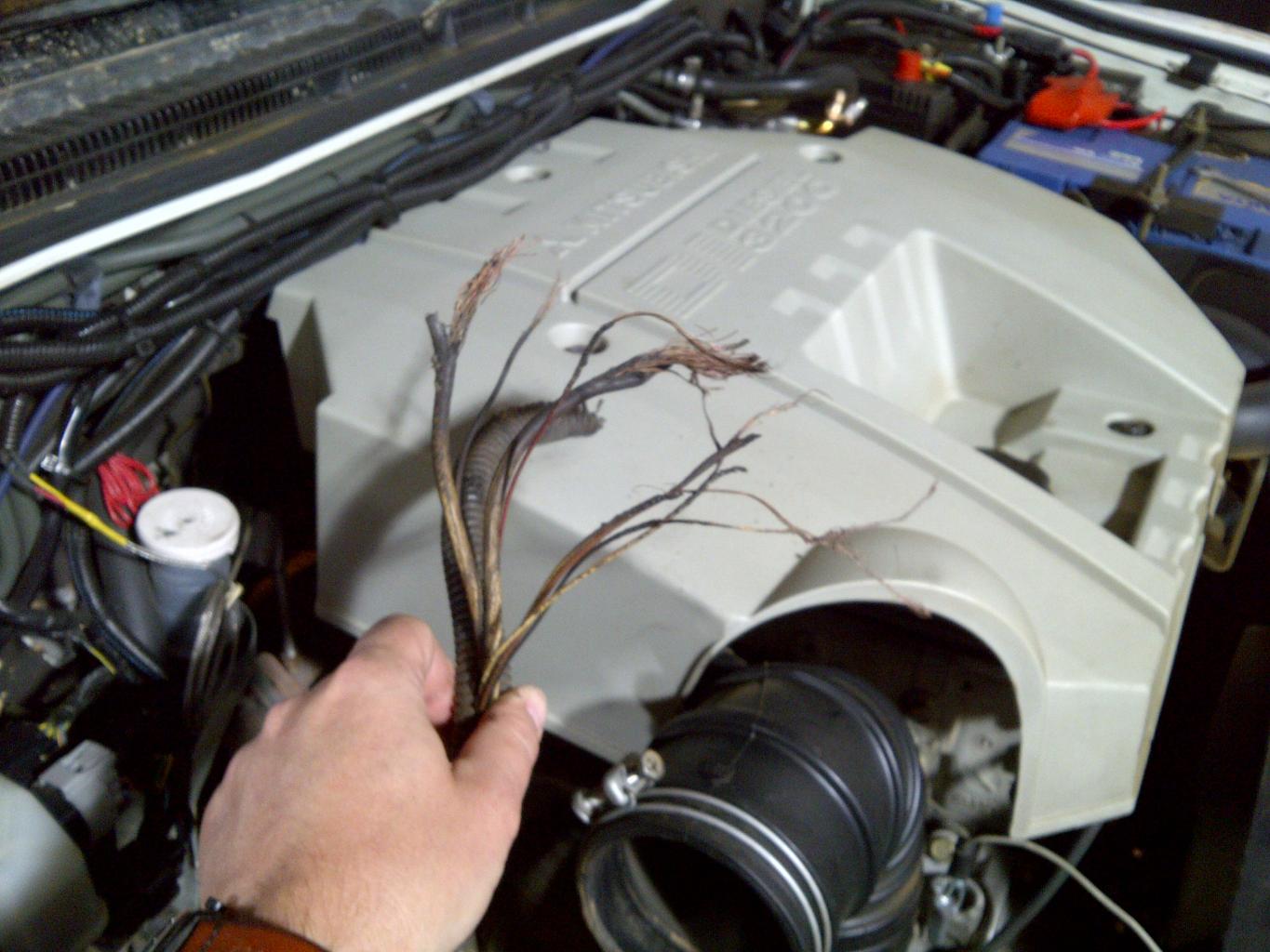

Back at home and busy sorting out some photos.
This what my wiring harnass looked like after the propshaft had a bite from it!! Amazingly I still drove without a hicup into the Auto Lec 200km after the incident happened!
The wire run underneath the gearbox/engine from the alternator to the battery. but was pulled up to the engine bay for the photo.
Hats off to Citrusdal Auto Electrical for getting me sorted on short notice.
Looks like a wireless Pajero
, that is hectic!
Cats,. You are one lucky son of a UHH something
That could have been some serious damage. Good luck with the rest of your trip
