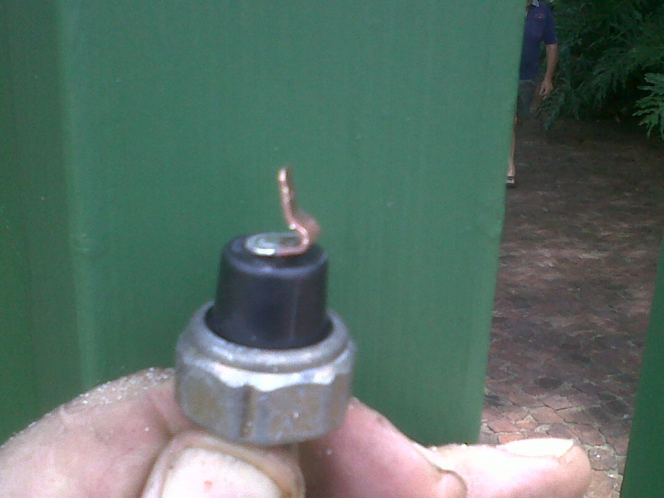

I modified the lug for the wire to the sender unit so it is situated in the middle of the unit.

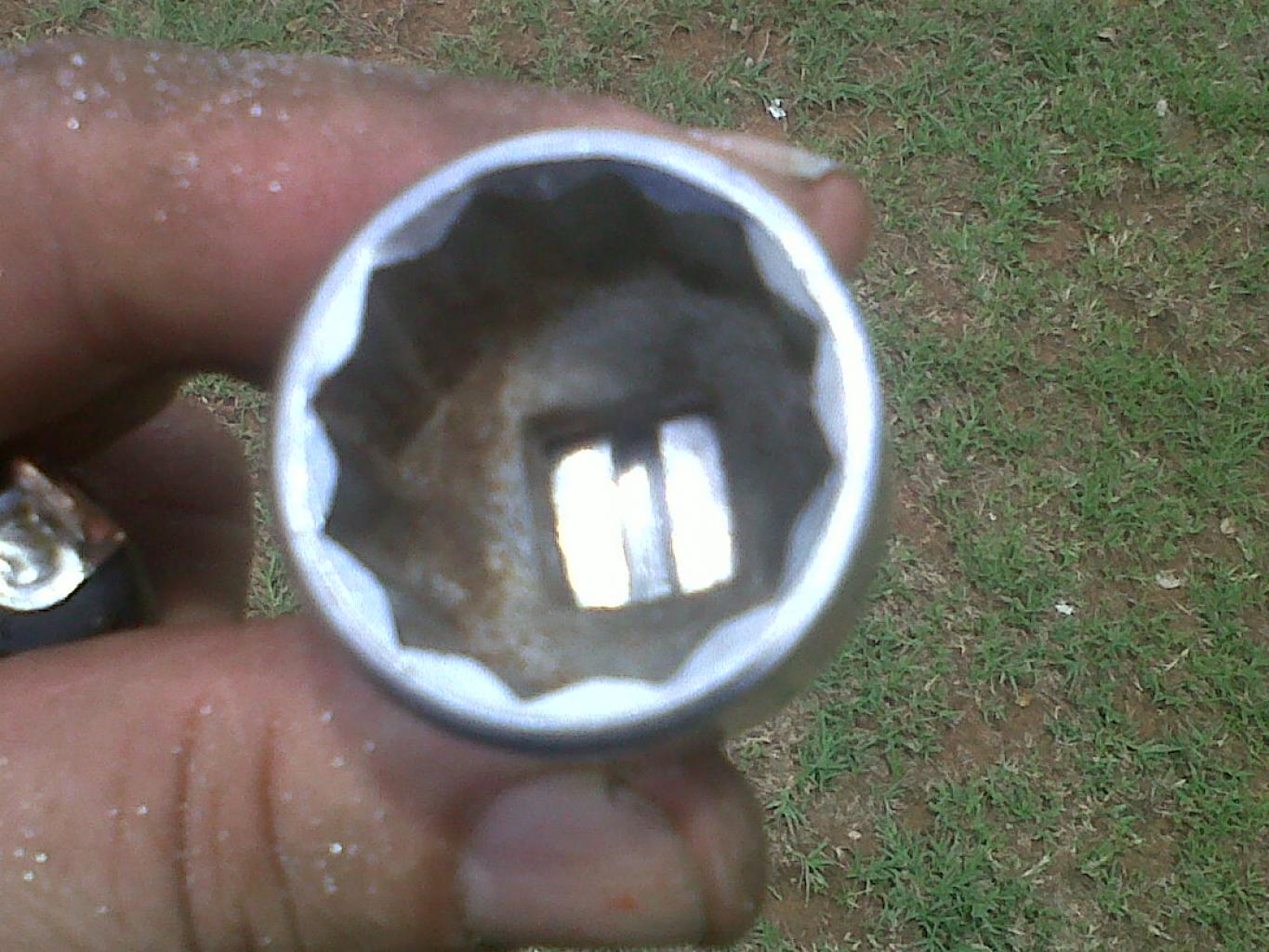

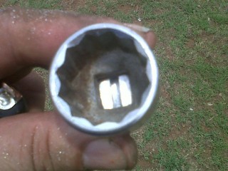

I then slotted the end of a 13mm aluminium square bar and hammered it into a 26mm (1/2 inch drive) socket.

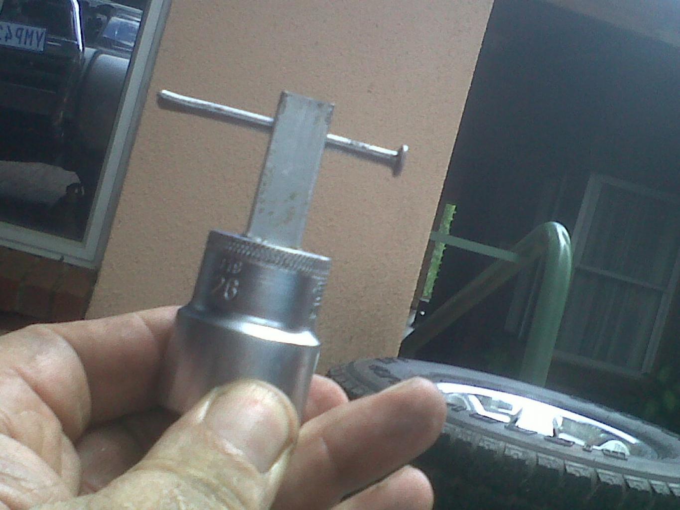

The next step was to drill a hole through the square bar ad fit a part of a 100mm nail through the hole to use it as a handle to turn the socket.
With this "make-do" spanner I fitted the oil temp sender unit, tightened it and "whalla" no more oil leaks. :P

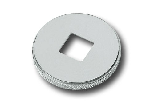

  1. I use a Gedore push-through ratchet. The ½" bar can be removed and fitted to the back of the socket, which can then be turned with either a short ½" / 13mm open wrench ("flat spanner") or a very small adjustable wrench ("shifting spanner" / "Danville Micrometer" :D )
  2. The same as above, but using the ½" swivel ratchet.
    Gedore Swivel Disk.jpg (14.88 KiB) Viewed 1624 times
  3. Use the Gedore Hand-Ratchet.
