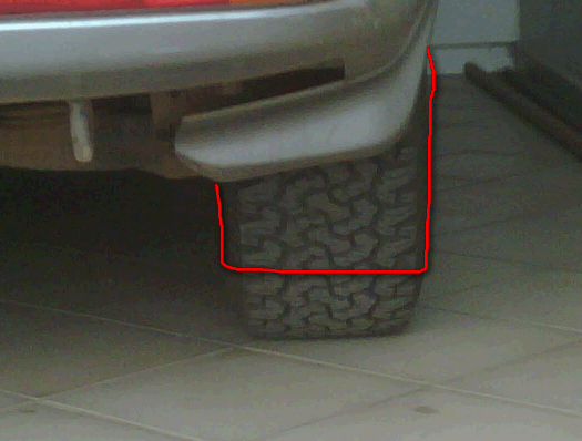

Hi Johan,

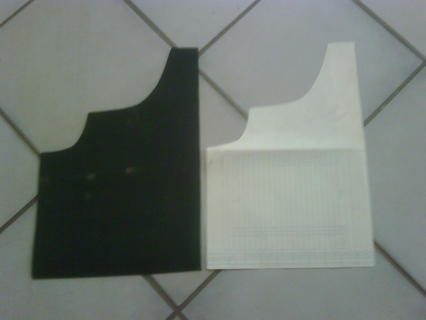

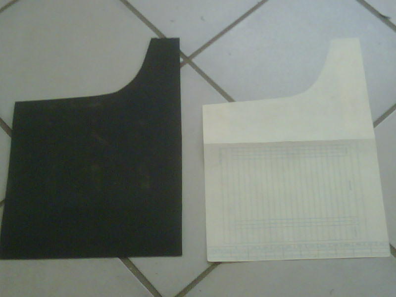

On the mudflaps, you have a few options to consider, 1 is to extend your mudflaps - see below pics - still need to fit mine, but if you lost a window already, you may need a more serious solution in the form of a full width rear flap - also relatively easy on the Paj - and will be making one in due course as well, which should connect to the rear recovery hooks and have a full cover of the rear, some guys use shad netting as well.
Re: Extra diesel tank & mudgaurds
I like the full width (as on the Dodge 4x4), but without the bling chrome bits! :D
I would make them longer (lower) though, to make sure no stones slip underneath the flaps.
Check that you can't drive over them though, when reversing over eg kerbs!

I have got some pics of Pajero full width mud flaps somewhere, just can't find them and no bling either, will see if I can find them, I am of the opinion it will be a very easy makeup and use angle iron and connect to the 2 rear recovery hooks, depends on the type of towbar used which will affect the design. Have also seen them connected on a plate to a towbar with square tubing on either side, which worked OK, 1 guy had this when we did the Kaokoland trip, but it didn't make it till the end, it was trashed before the end of the trip so take this into account, the type of terrain you intend driving. I guess the combination of both could serve different purposes.

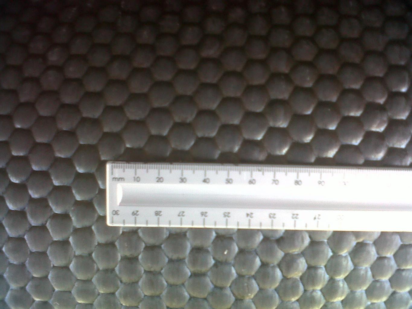

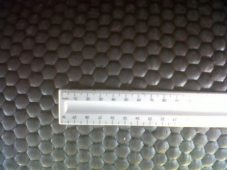

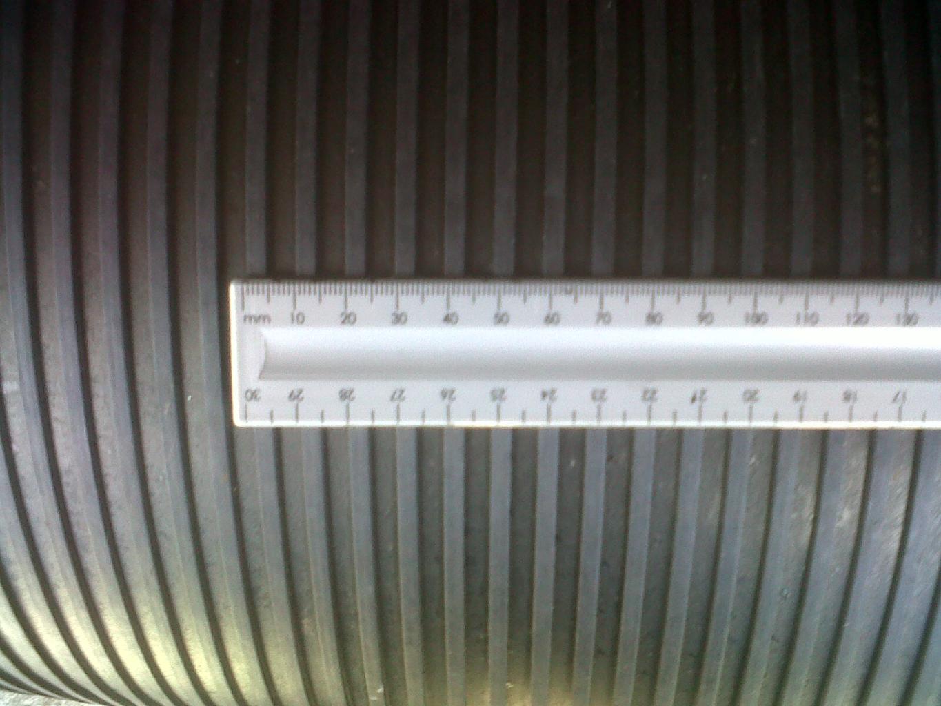

Rubber for mud guards.
I found some rubber that I think will be the perfect material for mud guards. See the photos below:
The rubber is available in rolls 1.1m wide. I can buy it per length needed @ R400 per running meter.
Regards,
Waldo Fourie
Size of Ribs
Size of Ribs
Size of Honey Comb Patern

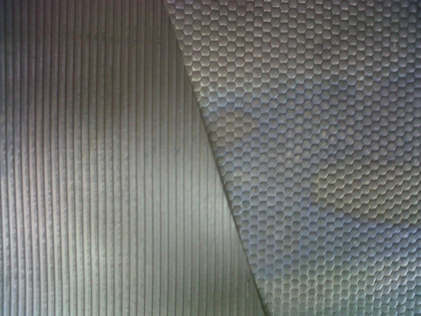

A section showing the profile.

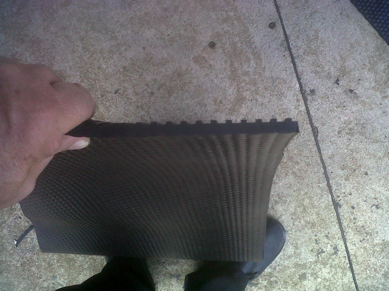

Two pieces show the front and back
