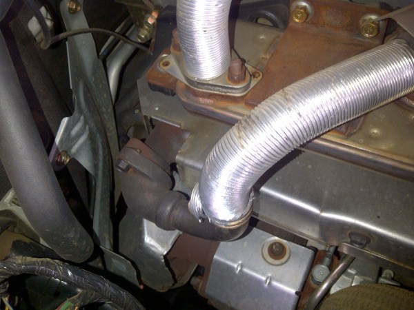

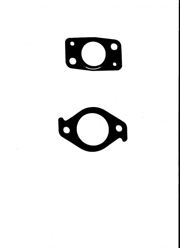

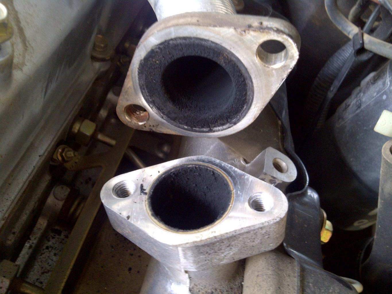

Below see the two gaskets that I scanned when I cleaned my EGR valve. You will need them to make blank-off flanges. They differ in size and I think one of each is all you need to remove and blank off the EGR valve and piping.
The small one will be needed on the intake manifold, while the bigger one will be needed on the other side of the motor when removing all the EGR pipes.
Otherwise, just remove the valve itself and blank of the pipes right next to each other.
Note: just print it on an A4 paper, normal size and it should be the exact same dimensions.

Just saw what you actually mean - those scans are to use as templates to get covers/blanks made specifically for closing the EGR pipe!

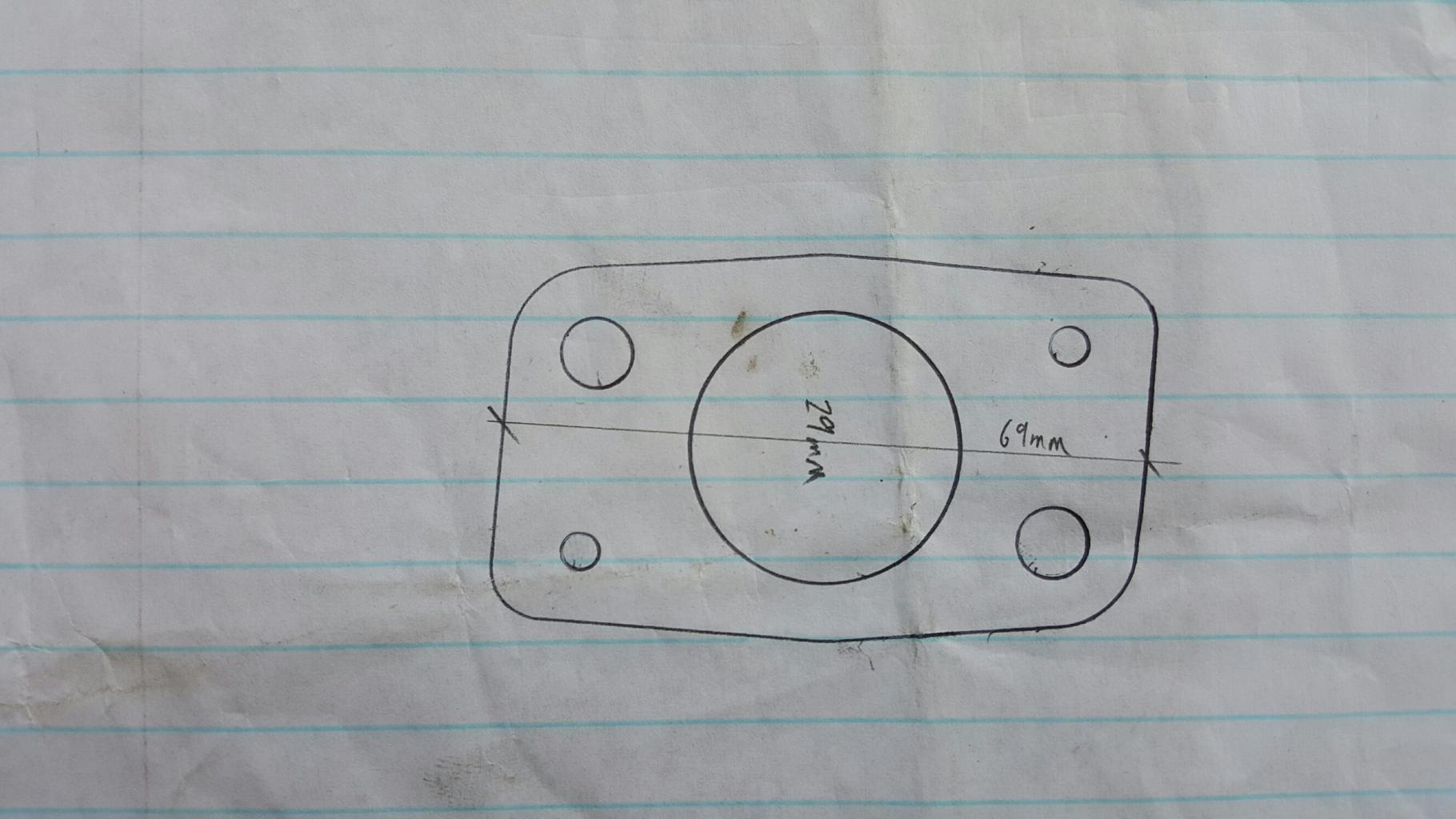

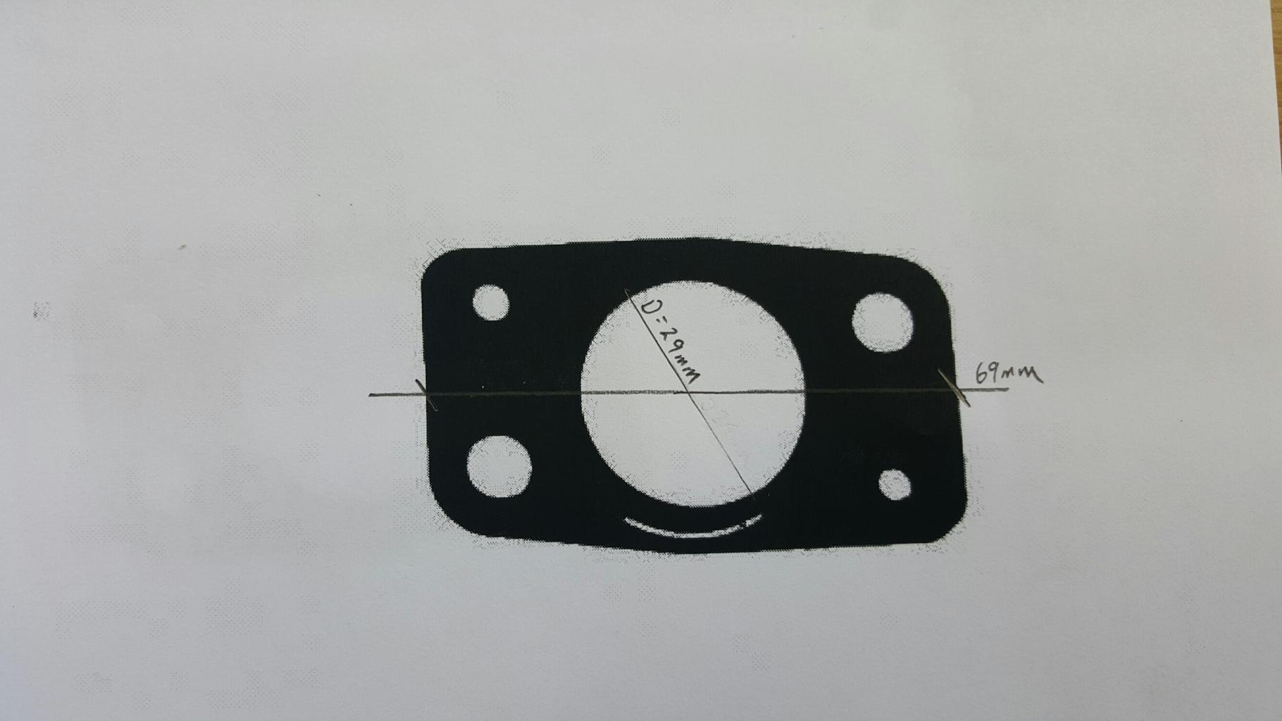

I tried to print the picture MacjohnW posted to have a template made up, but I struggled with the scale, it wasn't correct. I then made my own tracing of a gasket to scale Johns drawing correctly; I had to re size it by 111% from Microsoft Paint, and printed a scale A4 drawing to PDF.
Gasket Tracing
Gasket Tracing
Checked PDF scaling (100%)
You must print the PDF to 100%, no scaling (ie. fit to page, shrink to fit, etc.) to get the correct dimensions, double check off my pictures I have posted to be sure. I will have these cut from 6mm steel.
