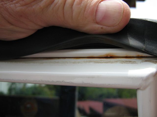

I have noticed rust on the upper portion of the rear doors along the entire length on my 2005 GLX just under the upper door rubbers. I checked on another 2006 model and found the same indications of rust but only on the rear doors. Has anyone else also detected similar rust. The vehicles are accident free and the rust is evident on both doors on both vehicles.
I will be seeing the agents today to discuss the matter but please indicate if this is a common problem.

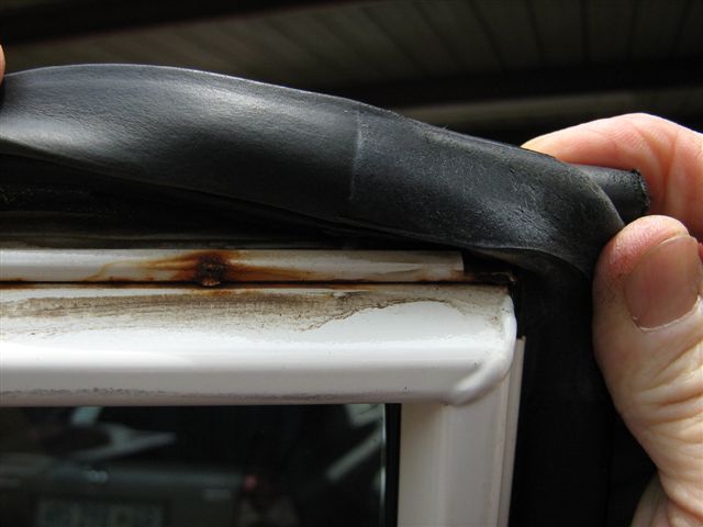

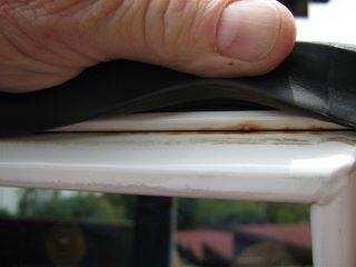

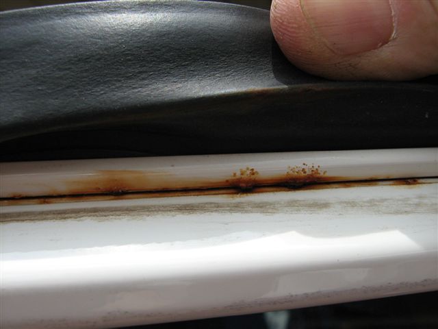

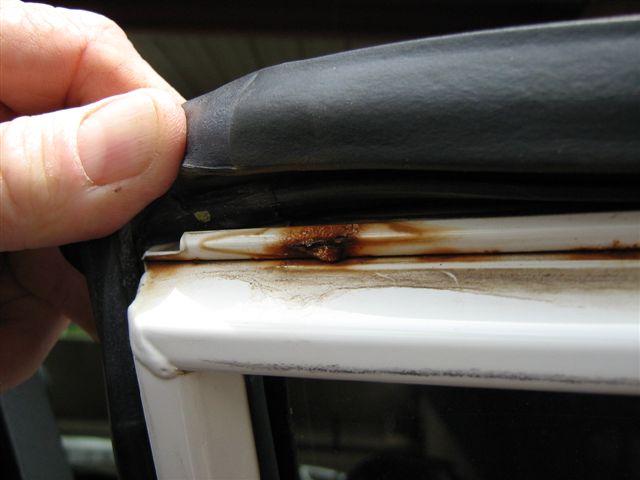

After meeting with the agents I was requested to submit photographic evidence of the rust. These would then be forwarded to Daimler Chrysler for an opinion. While at the workshop I had the opportunity to check another Gen 3 GLX and the rust on the rear doors is also evident.
A response from DC is still pending.
In order to determine the extent of the problem I would ask all GLX owners to view the attached photographs and check below the upper door rubbers of their vehicles if any rust is evident and indicate via the forum what was revealed.

This is rather serious rust for a vehicle that spend most of it's time in Gauteng.
What does the the guys down at the coast look like?
