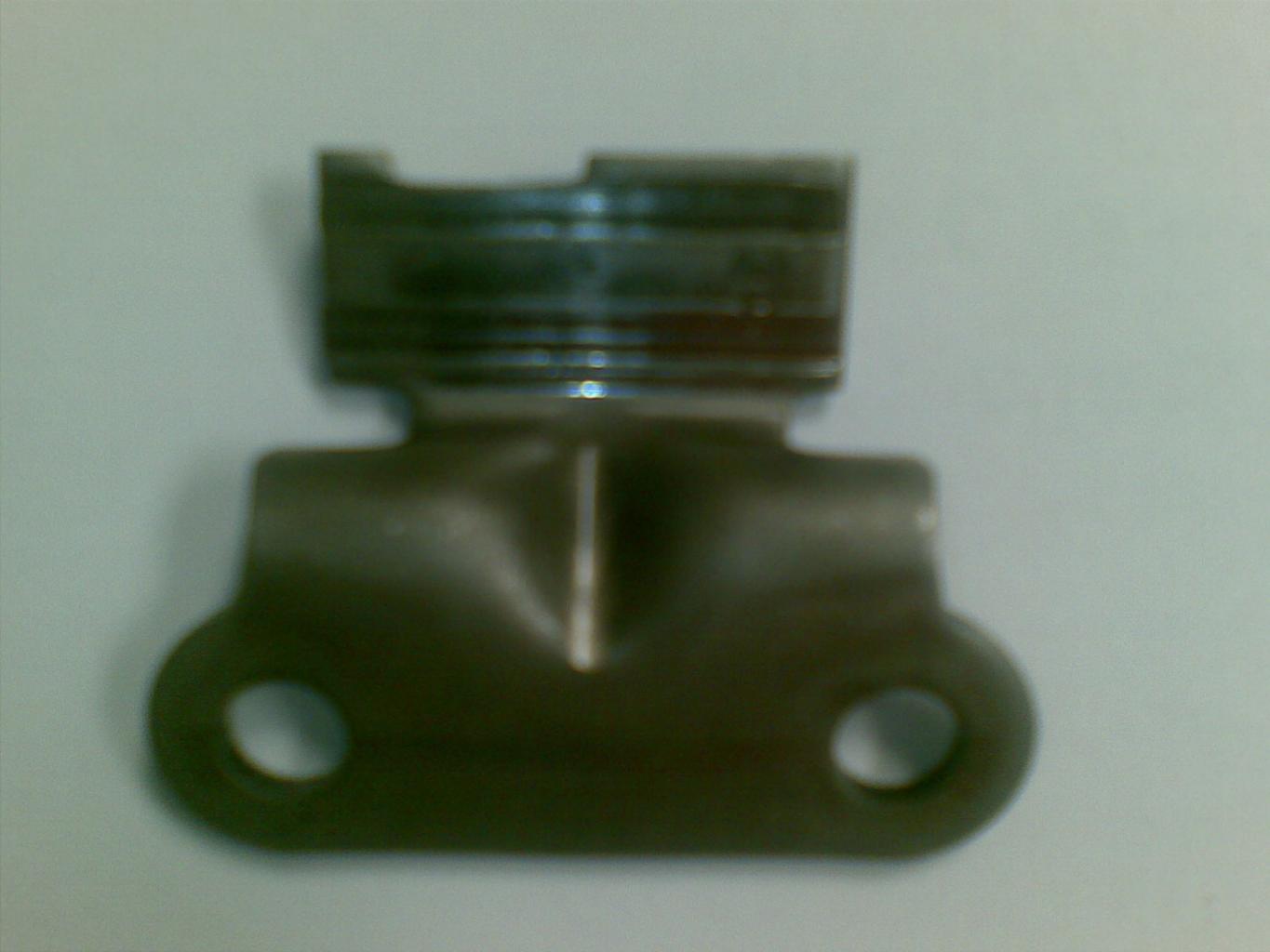

The old top chain guide showed little wear apart from two slight grooves in the plastic - see attached.

Hi D,
I am very interested to know what milleage your car had done at the time you changed the timing chain guide. Your guide hardly showed any wear. Has it perhaps been changed before? The general advice I have had so far is to start checking for chain guide wear only from about 150000 km. Does that tie up with your experience?

Hi Bigwill,
I had the chain guide changed at 150, 000 km.
I don't have a lot of experience, but from what I've read people start thinking about changing it from 150k. Correct, my guide showed very little wear. I wasn't that surprised by this - excess chain guide wear and failure does not happen in every 3.2 did (I'd say it's quite uncommon IMO), but it has been identified as a weakness so people replace them in higher mileage motors.
My old guide was the original. The new guide is made from white plastic (not orange), which is also slightly thicker and wider than the original part.
It's not an expensive procedure and if you can do it yourself its even cheaper. The guide only costs about 90 bucks.

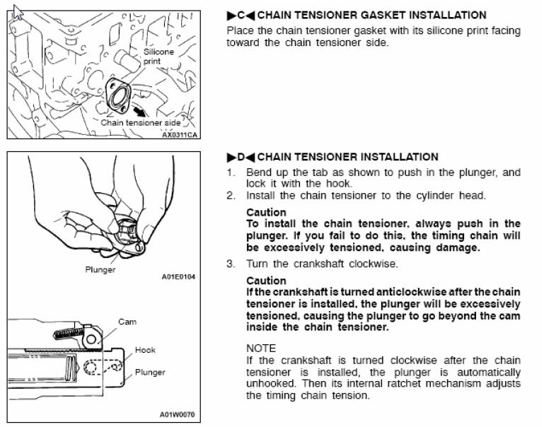

any thoughts on resetting the chain tensioner?
the tensioner on the side needs to be reset.
It unbolts with two bolts on the side of the head and pulls out.
You then unclip and push the tensioner all the way back and hook the little hook.
Best is to then pull the tappet cover, turn the engine via the crankbolt clockwise and make sure the tensioner releases from the hook.
