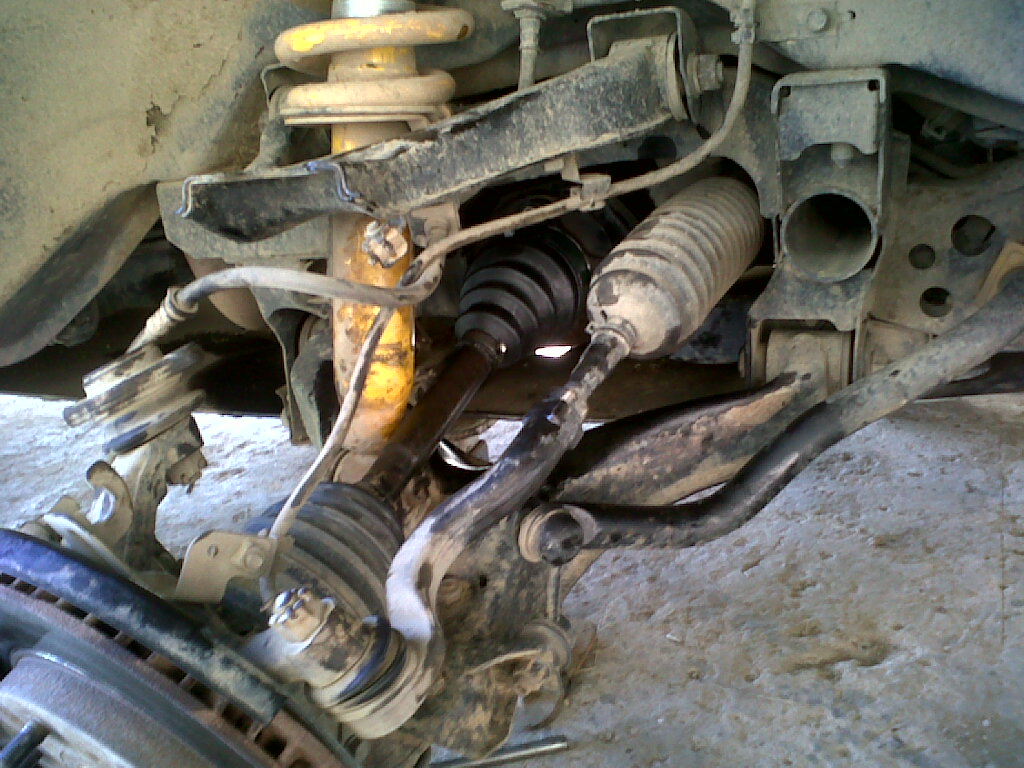

I changed the inner right CV boot last week and noticed some play on the receiving CV cup.
Some inspection on the net and the workshop manuals revealed that the inner shaft bearing was the likely culprit.
My job today was to strip the suspension for the 3rd time this month.
bash plat off - I hate this job as it weighs a ton!
wheel off
top ball joint off
top control arm off
coilover shock spring off
inner CV cup off
swivel half shaft out of the way
fabricate sliding hammer to get the inner shaft out

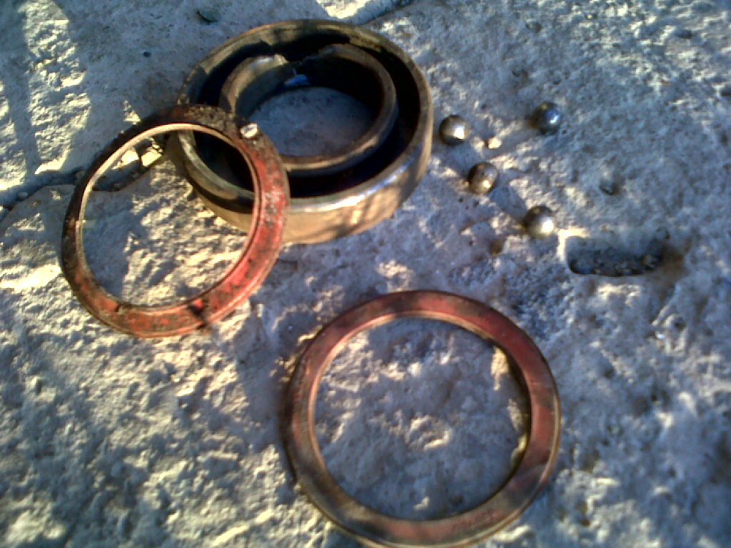

what remains of the old bearings balls falls to the ground
grind the old inner casing off carefully
manufacture a press for the new bearing
press bearing on
reassemble

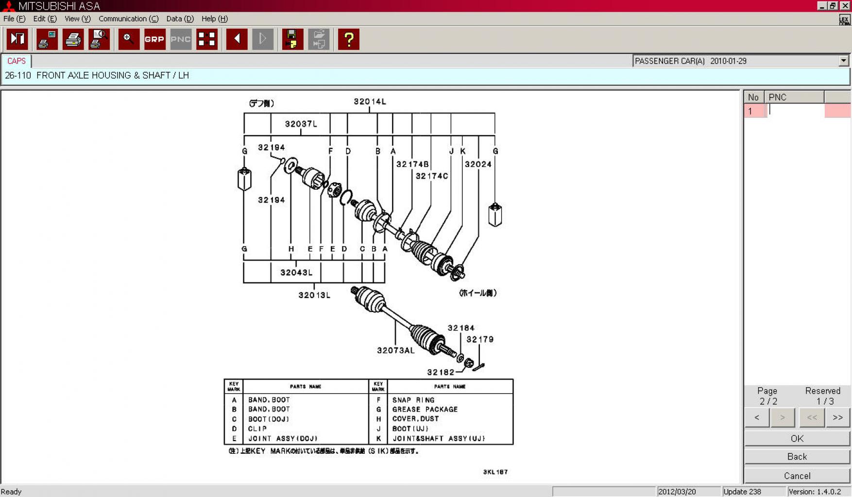

Luckily the left side has the halfshaft directly connected to the diff so It's bearing is in the diff with a ready supply of oil.

The bearing is a sealed bearing. It looks like this. (albeit larger than the one in the pic)
I didn't take pics or measurements of the new one but just measured the old one now.
Inner diameter : 35mm
Outer diameter : 62mm
Width : 14mm
Markings on the orange side seal : NTN 6007LU JAPAN

That is a standard NTN bearing, which can be bought from any bearing supplier.
Most brands (SKF etc) will have an equivalent.
