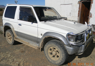

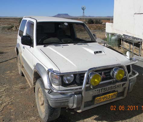

I was given a 1998 2.8 TDI Pajero from an estate. The owneer had put a re-con engine in but it blew, literally, a year later. I took the engine out and replaced rings, bearings, con-rods and all....then discovered the head was cracked....so put in a brend-new head. It started and ran....for about 10kms...over heated and the head-gasket blew...again! what next?...the battery, starter-motor, radiator, glow-plugs,alternator, thermostat, water-pump....all replaced! R20k later....it smokes, wont pull, over-heats. I have no experts or service facilities in the Karoo.....the car has been off the road for 10 months now and no sign of an end to the problems!....Do I give up, cut my losses and sell to the highest bidder?

Thanks for your reply....I want R35,000 for my Pajero....I already spent near R20,000 on it...Engine plus battery, starter etc....it has brand new Bridgestone AT Duelers (@R10,000)....body is perfect. It needs a windscreen for RWC. It is not currently registered or licenced (We are on a farm Near De Aar, Northern Cape) but has police clearance for chassis and engine and weight certificates
