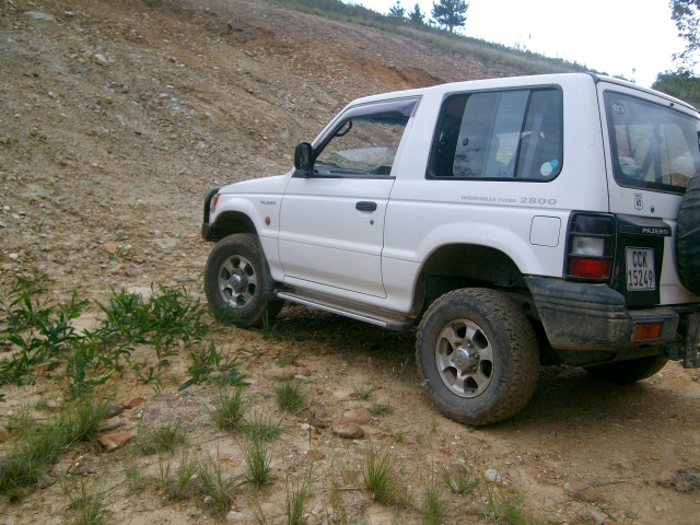

I recently bought a 1998 2.8tdi Pajero Swb Glx. I want to know what size tyres did it came out with. It currently have 245/75/15 on and they look to small for the body. As far as I can tell it still have the factory fitted rims. Here are a pic of my pajero!
Nice wheels...
I thought the standard size was 265/70, but there's only 3mm difference in diamater between the two
