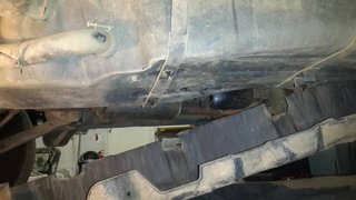

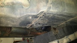

Hi guys, just to revive an old thread. I did the clean of the fuel gauge sensor in the tank, it works perfectly out of the tank, but not when it is inside. So I removed the plastic fuel tank cover, and found the dreaded dent right below the fuel sensor float...
Dent under plastic cover 1
Dent under plastic cover 2

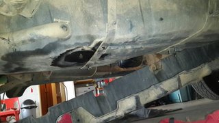

I then removed the Seats and carpet and took out the fuel level sensor and fuel pump/filter assembly. I then drained the tank completely with the drain bolt and the last remnants with a home made catch bottle, two fuel hoses and rubber duck pump connected to the vacuum port.
I then mopped up the last drips of petrol and dirt with a rag in the tank to make sure it was as safe as possible to work in the tank. I then (with a fire extinguisher very close) took a thick wooden pole (pick handle) and a 4 pound hammer and proceeded to carefully tap the dent out through the fuel sensor hole. It moved out/down by approximately 40mm, and when I put the fuel sensor back in it worked through its full range as the yellow light came on immediately.

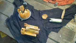

I also gave my fuel filter a bit of a clean/flush while I was there, I rinsed it out in reverse with clean petrol - lots of rusty debris came out, will have to get a new on as soon as I can.
Fuel pump & filter assembly

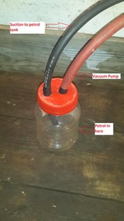

I thought should post my home made catch bottle, I used a rubber duck pontoon inflator pump to create suction to drain my fuel tank of the last 4 liters, worked quite well!
Catch bottle
Catch bottle
I put one hose into the tank and connected the other to the pump suction, and as soon as the bottle was nearly full I emptied it out - very dirty petrol! Better than mouth-fulls of petrol trying to siphon :D
