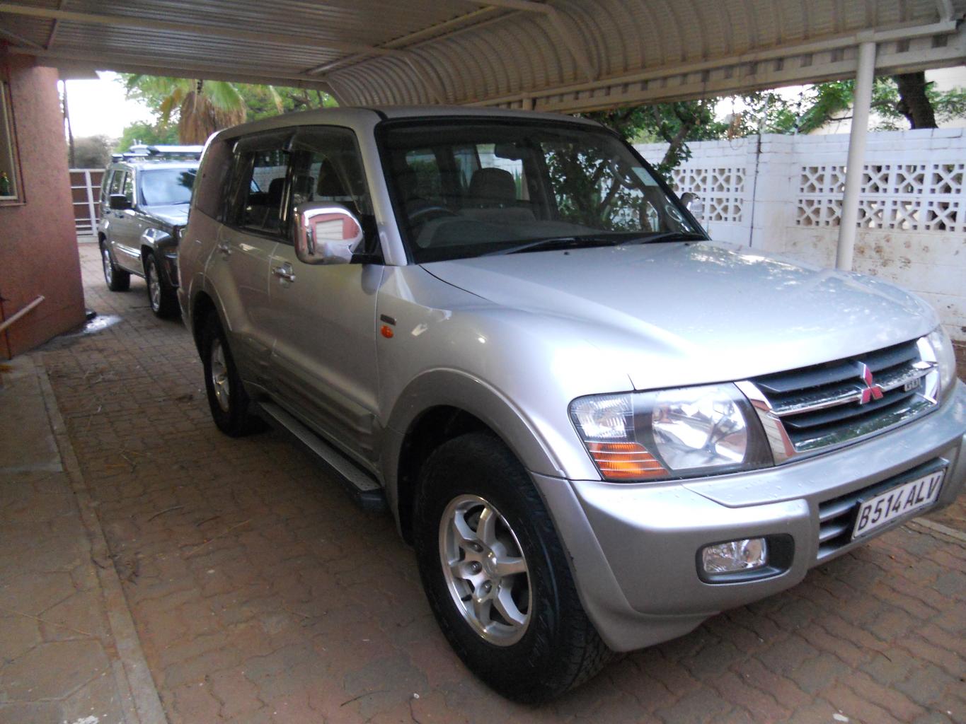

i hope you are all well, please could i ask a stupid question, could someone please tell me what "Gen" pajero this is, i have just got it and now want to get it ready for the bush but i need to know what parts i need to ask for.

Exam passed you are ready for the next levelghost_traffic wrote:Finally!! A question I can answer.
That would be a Gen 3.![]()

Wow that is a real bargain for a Gen3.
Things to consider for getting bush ready will be the following:
Good set of bash plates - see stofpad 4X4 for one of the best
Spacers for a little extra ride height and ground clearance also from stofpad
Good set of AT tyres
Consider a snorkel for the wetter parts of Botswana
Full tank of petrol and some humour and you are all good to go.
