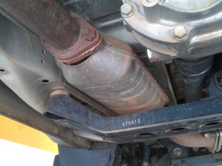

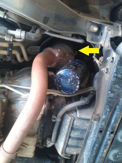

I went to Speedy in Midrand to have a look at removing my CAT, and there I'm told that I have 2 CATS...
Being the first I've heard of it, I decided to go check what my Ellery's manual says (cant find my Haynes one - maybe someone can check what it says)...and it only shows one CAT.
So, Questions 1:
The typical CAT is easy to identify, but is this other one that sitting close to the engine also a CAT?
The suspected 2nd CAT
The usual CAT
The usual CAT
Q2:
I assume its pointless to replace the usual CAT if there is one right near the engine? So will have to put a straight pipe there as well.

OK. I think I've answered my own question.
Found my Haynes manual, and this is what they say (although not in a lot of detail...):
So they call it 'turbo charger exhaust adapter', so its not a CAT.
Good news - makes things simpler.

Pajeromania, If I read that diagram correct it seems there are 2 CATS!
Anybody agree??
Re: Gen4 and Cat removal
Posted: Mon Nov 05, 2012 8:13 pm
by Pajeromania
As shown in the Parts Catalog - Pajero `07
