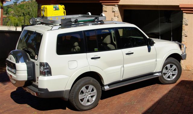

Hi Almal,
Hiers 'n kiekie van die nuwe baba op my werf :mrgreen:
Tot dusver: ARB bumper replacement, IPF 8", 12500 T Max winch, TJM suspension, Takla covers regdeur
Wat hopelik die naweek in kom: FM radio, Roofrack en trailer charging system
Toekomstig: dual battery en laai stelsel, snorkel.
Cheers Pierre'

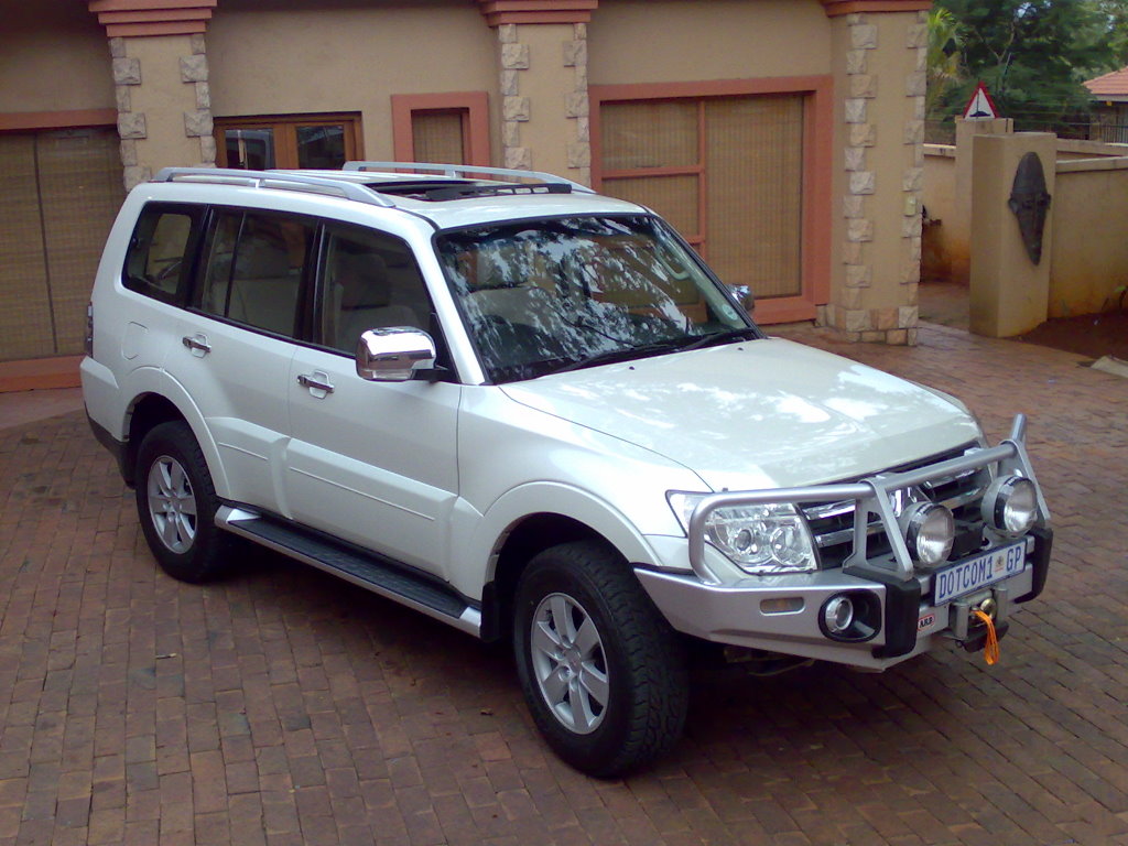

Here is what I did on mine.
and here is my fusebox location under the cubbyhole

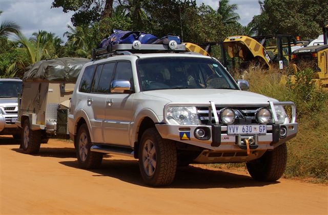

OK, so she's had a couple of changes. This is what my baby looks like now. Were leaving for Nam on 12 June doing a 4 week trip from Augrabies to Spitskoppe.
Done sofar since prev pic: custom drawer system, trailer charging system, dual battery, FM and 29mhz radio's, roofrack, KC on roofrack and dual jerrycan holder. Next to come Airtec snorkel if I can find me one :?
