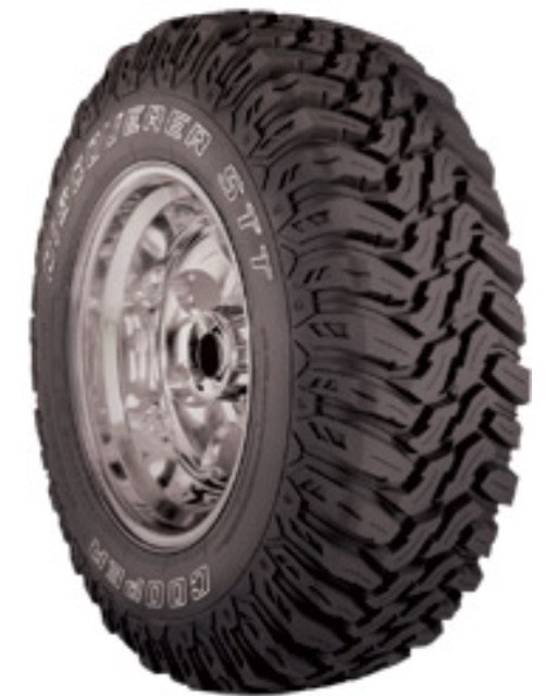

Hi guys,
I am looking for Cooper STT 165/70-17 tires in Cape Town. I tried some of the tire dealers here in the Southern Cape and that made me decide to go to Cape Town next week to buy my tires from there.
Some of the dealers I visited here promised to come back to me within an hour or so, well hours, then days and now a week has gone by, no callbacks!
Other dealers tried to bully me into buying some other brands which I don't want!
I am just looking for someone who can supply what I am asking for at a reasonable price, is that asking too much? If I had any interest in any other make of tire I would have said so, but I don't.
Anyway, please help me to find some tire dealer in Cape Town who can supply me with 5 or 6 Cooper STT 165/70-17 tires (quantity will depend on package deal price).

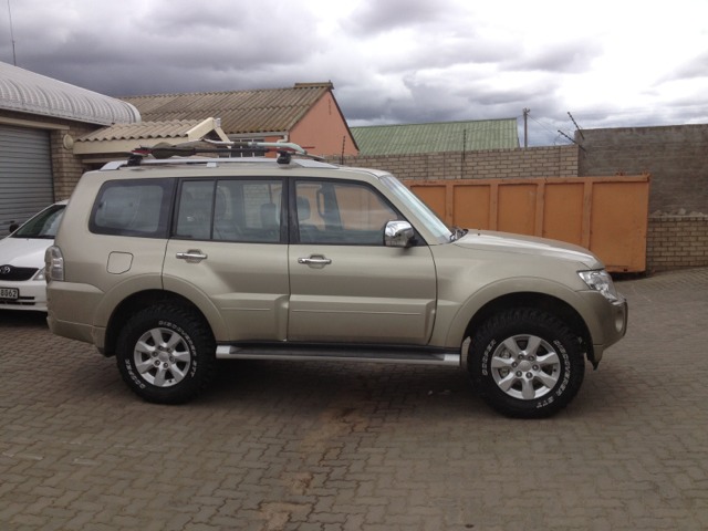

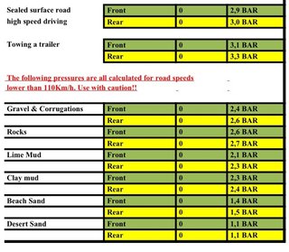

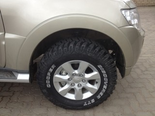

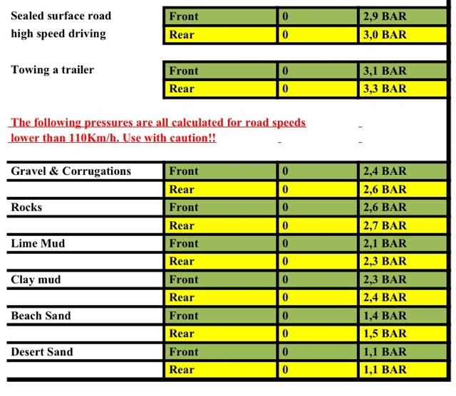

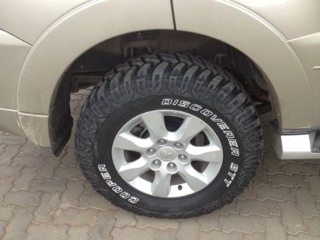

I fitted the new 265/70-17 Cooper SST's today. Once fitted I checked for any problems, but they fitted like glove. I calculated the on road pressures, then inflated the front tires to 2.9 Bar and the rears to 3 Bar (included a screenshot of the pressure calculation program results).
I have not been able to test drive the tires today, because I had her on the lift all afternoon laying the cables for the rear and front mounted winches. Will test drive the tires tomorrow.
One thing I noticed driving home was that the tires are quite noisy on tar roads, but since I do 80% dirt thats not an issue for me.

Thanks for these posts!
Im interested in how you calculated the pressures for the different conditions? Does it factor in the loading on the vehicle?
Also, could you send a pic of the front tyres at full steering wheel lock (left and right)? Id like to see the clearance with the front of the wheel arch.
Quite excited to see that the bigger tyres fit! :mrgreen:
How does the drive differ ? Acceleration, gear changes and torque converter lockup at around 120km/h?
