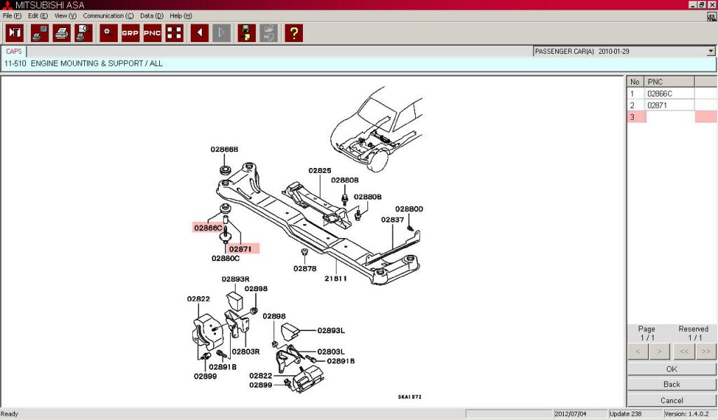

You mentioned the bridge gaps to be harsh which points me too only one thing. Suspension bushes, gearbox mountings and in particular the crossmember bushes under the gearbox.
To eliminate the suspension bushes, take it to a dekra test center where they put one wheel on a circulating platform to stress the suspension. This will show any bad bushes. Fix those and then have a look at the engine mountings. Put the car in Neutral and rev it a bit while looking at the engine. It shouldn't rock more than an Inch at the most. Mostly it should rock less than an inch.
Then lastly the crossmember bushes under gearbox. It's just 4 x 14mm bolts on the body , 2 x 14mm bolts and 2x 14mm nuts on the gearbox mounting to drop the crossmember and inspect the bushes.

4) The expanded diagram for removal of the gearbox Crossmember: Where can I get it in PDF or whatever to view properly? On the page here I lose all defenition when expanding.

4- Have a look at the attached PDF, it an early service manual for the 2000-2003 Gen3 Pajero power plant mounts.
PWJE0001_PAJERO_2001_CHASSIS_32.pdf
Engine mounts
(240.76 KiB) Downloaded 499 times
