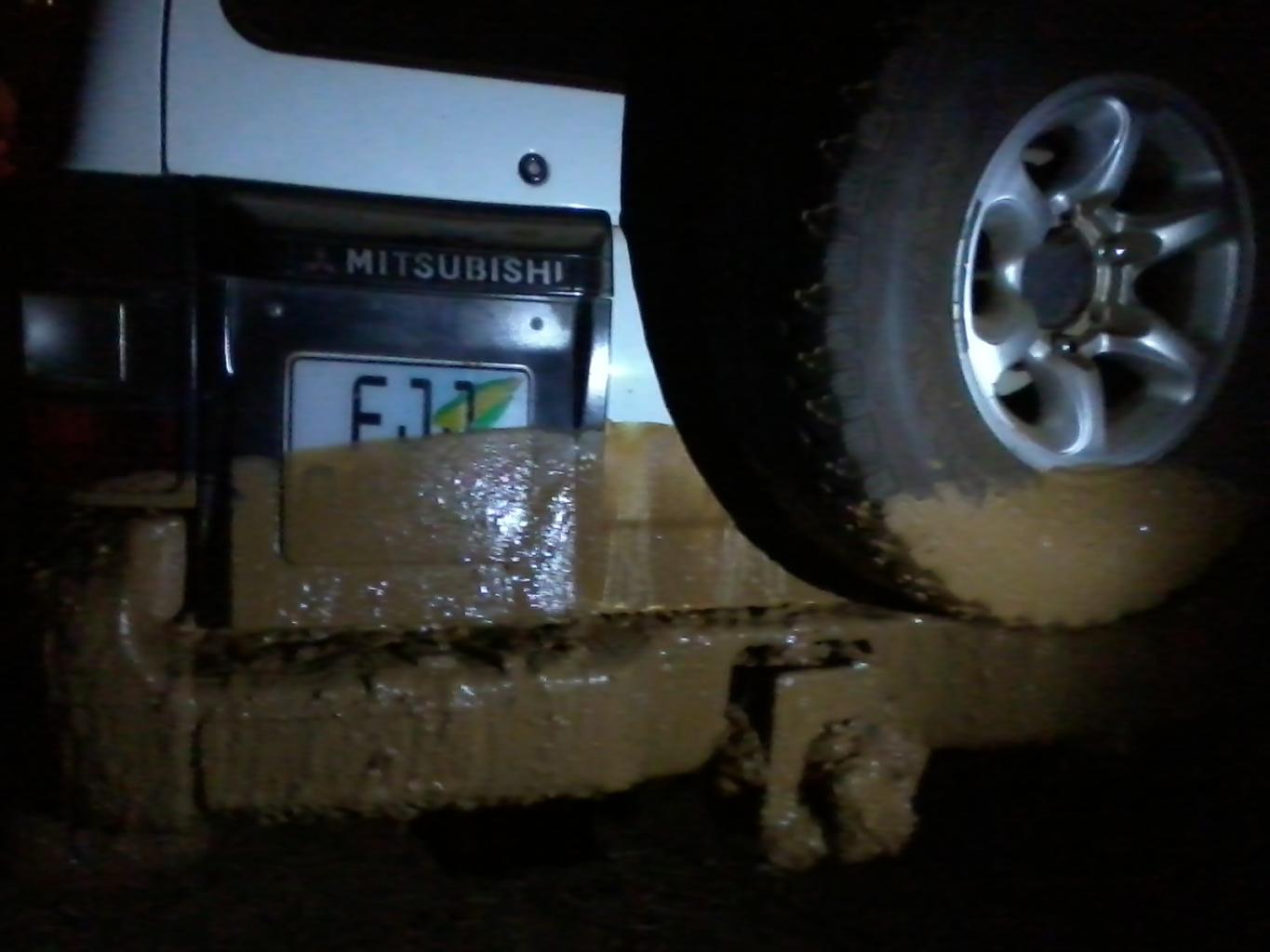

hi guys thanks for the input we split the gearbox yesterday and have discovered that the clutch is still about 60% ok but have found that there is a lot of dry mud inside the casing and this seems to be restricting the movement on the plates and other bits but i am going to replace the clutch plate and release bearing anyways as i am already there the cost of this should be in the R4k mark and labour is R1200 will say that i wont go anywere near mud as deep as that again will upload a photo. Thanks once again
Eish - MUD ! The Destroyer of many!
