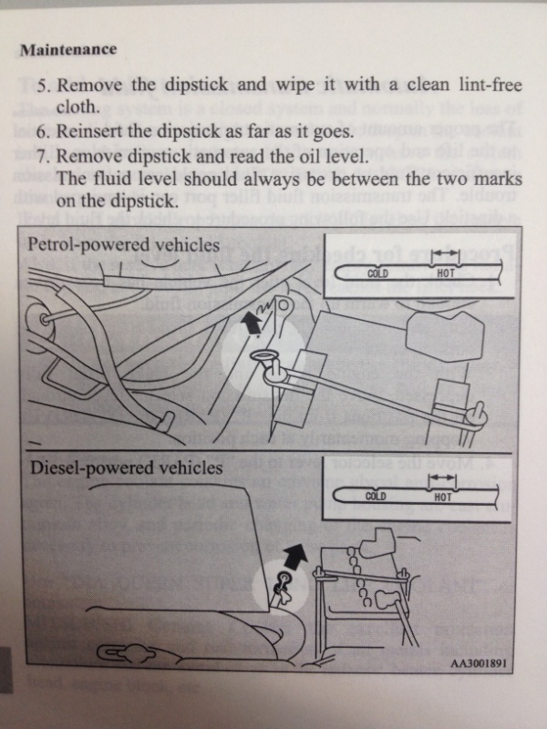

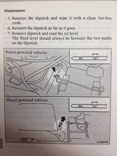

Interesting this because I need to top mine up. So here is a question because I want to make sure. When checking the ATF level, the manual says the level must be between the 2 notches. I presume they mean between the 2 HOT notches ?
Mine was between the COLD and the lower HOT notch. I have read else where that low ATF level could be a factor towards my Traction control lights coming on when under load up steep hill or towing caravan.
IIRC the correct way to check the level after a fluid replacement (and once you know you have sufficient oil in when the ATF is cold) is to:Dirty Boy wrote:Interesting this because I need to top mine up. So here is a question because I want to make sure. When checking the ATF level, the manual says the level must be between the 2 notches. I presume they mean between the 2 HOT notches ?
1. With engine running move the gear lever through the selections - Park, reverse, neutral drive etc. a few times
2. Check the COLD level again that it is sufficient = above the cold mark.
3. Go for a decent drive to get the ATF up to working temperature then stop on level ground in neutral with the engine running and check the level again. The oil level should be at the top hot mark.
ie the hot level mark is with the gearbox operating, not with engine turned off.
