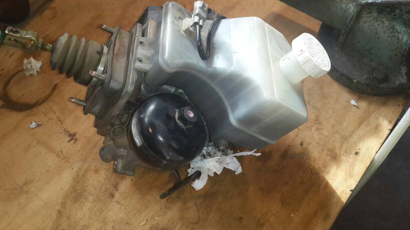

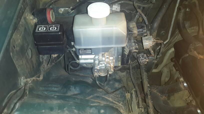

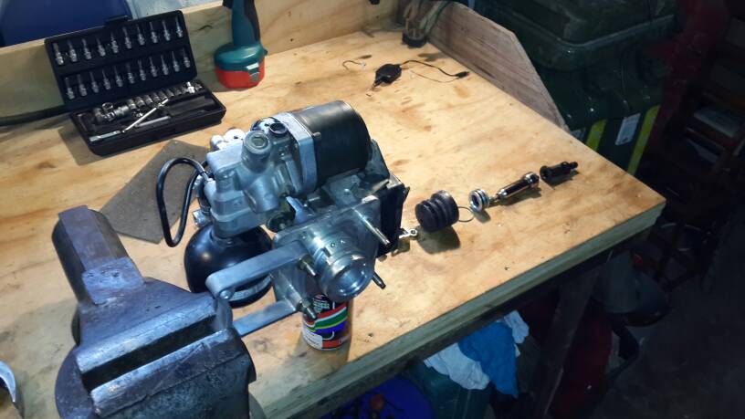

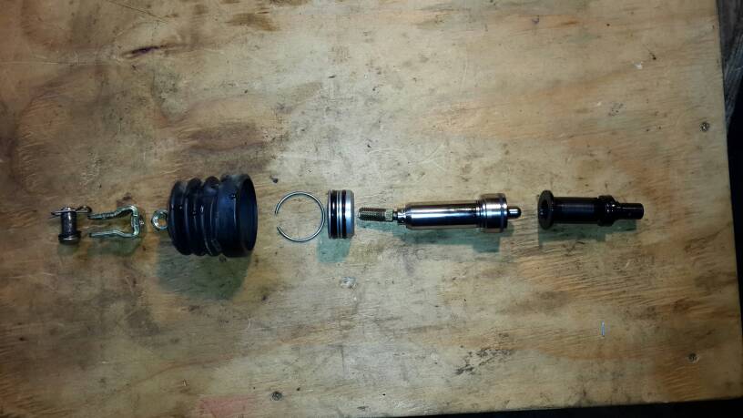

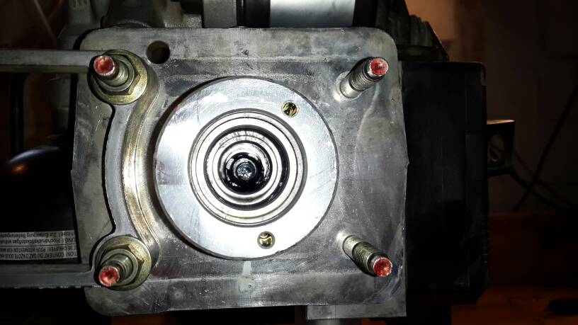

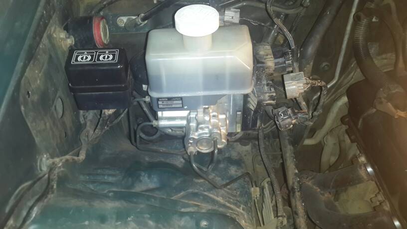

OK so I did a bit work on the paj last night and this morning.
I took the whole hydraulic brake booster assembly out of the Pajero today and looked at the power piston seals and master cylinder. All good, no pitting or rust and seal in perfect condition.
After that checked out I looked at the high pressure nitrogen filled accumulator, it has a bladder filled with nitrogen to store braking pressure generated by pump. This was replaced under a factory recall 2 years ago at mitsubishi. If the bladder fails this could cause all the small bubbles in the reservoir on pressing the brakes and the noise I am experiencing under braking.
I will now try to see if I can claim another accumulator from mitsubishi, failing that u will try to source a second hand one out of a breakers yard. New ones are hellishly expensive.

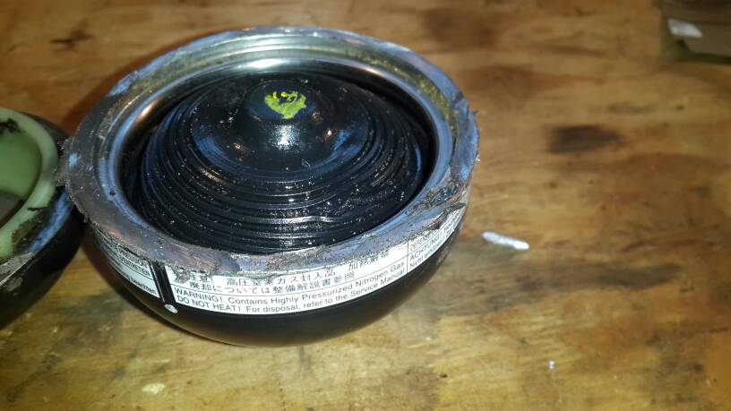

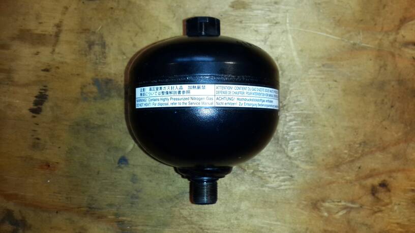

Just some more feedback. I had some time and was curious as to what the inside of the accumulator looked like, so I cut it open... I first drilled a hole to release the residual pressure (and there was none) as per service manual and then cut it open along the seam with a grinder, it is quite solid as the steel is about 8mm thick. Here are the pics.
If you look carefully you can see the tear the rubber diaphragm.
The last pic I have inverted the diaphragm to show the tear more clearly.
I am sure a hydraulic supply company could make one up to suit as they are used extensively on machinery running high pressure hydraulics. Will make some calls today to see if it is possible/feasable.
