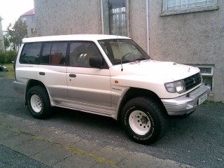

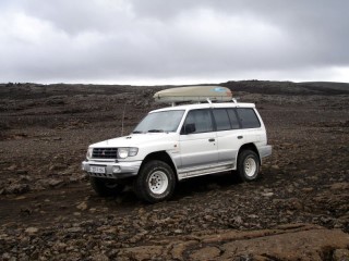

Here is my long wheelbase blister fender on 33x12.5R15. It has 40mm suspension lift and the cars imported here may have a small (25mm or so) bodylift, I'm not quite sure about that. The front wheels rub against the mudguards when it hits bumps with the steering at full lock, but that's easy to fix. The only reason I haven't done it yet is that I'm fitting fender flares and doing rather more modifications in the front wheel well. The idea is to be able to fit 35" tires, which requires some minor cutting.
The 10" steel wheels I have extend out a bit more than the 10" aluminum wheels I had previously so the tires stick out quite a bit from under the body, probably at least 30mm.
Blister fender with 33x12.5R15
Pajero in driveway
Pajero in driveway
Re: How radical can one go??
Posted: Mon Oct 05, 2009 5:45 pm
by steve
hi,
thanks for the pix,looks nice.
