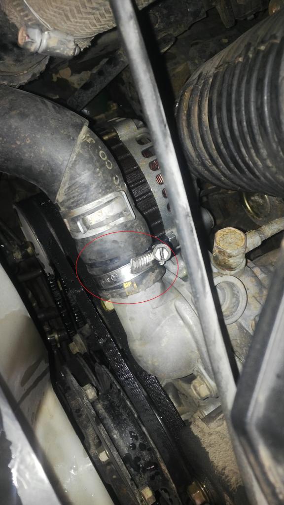

Went to Silverton and they did a pressure test. Water pisssing out. looked like it was coming from the fan covers as nothign from the front.
tootl the air intake flat pip off and tested again and we could see where it was coming from. the pipe under the air intak clamp was not sealing.
New clamp R0 and all tested 100%

zeek wrote:Went to Silverton and they did a pressure test. Water pisssing out. looked like it was coming from the fan covers as nothign from the front.
Glad to hear you found the leak.
Hope no damage to the engine from overheating.
If the OEM clamp was left where it is shown in the photo it is no wonder that it was leaking! Or was it moved back when the replacement clamp was fitted? (In which case one asks why leave it on the pipe at all?)
Re: Temp guage up and down
The OEM clamp was the one that leaked. to do the test they just moved the old clamp back and added the new clamp and I took the picture. They never seem to seal correctly once they get opened in my experience
that clamps tends tobite into the rubber over time. The OEM clamp is much better.
I would get a new pipefrom the dealer, clean the mating surfaces thoroughly, apply some silicone spray and install the new pipe with the oem clamp.
As a safety measure, have the coolant checked for exhaust gasses.
