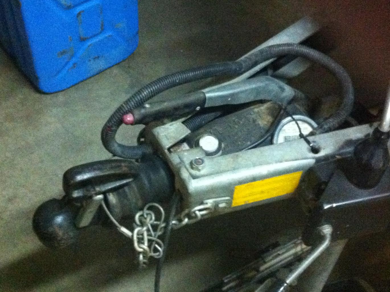

Well I run an Echo Chobe caravan behind my Gen 3 and I have solved this problem by modifying the installation of the coupling mounted on the caravan's A-frame. It was previously bolted on the top channel lip of the A-frame and I refitted it to the bottom channel lip of the A-frame.
I also lowered the caravan's riding height slightly by rotating the axle 180 degrees en so removed the standard lift blocks under the U-bolts. My rig now runs level and I can open the back door of the Paj right up against the caravan's spare wheel.

Bigwill. I also have an Echo Chobe. Have looked hard at the axle setup and thought about removing those lifting blocks, but never thought about turning the axle up side down. If you would be so very kind and send ad many pics as you can and as much info as you wish about both the nose and axle jobs, then I'll be terribly indebted to you. Many thanks in advance. Your servant, Roelf
