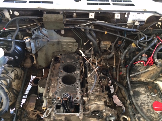

This morning I opened the bonnet and took a pic of where we stand at the moment. As can be seen the head has been removed. The only last two little jobs to be done is removing the injector pump and the starter motor. Most of the bolts around the bell housing and engine mountings have been removed or loosened. So we are ready for the big heave on the weekend.

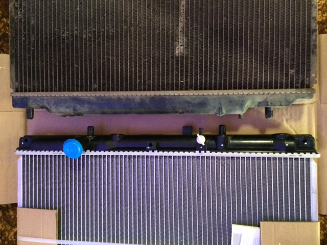

As discussed in the welcome thread here is a Pic of the two radiators showing the mounting lug differences. Once I have removed the motor it will be easier to relocate the mounting points on the vehicle. I will still try and find the correct radiator but I am not paying R8k when the one I bought is R1.5k.
I have not checked or measured the tank capacities of the two radiators which I will do, but by the looks of it, the new Colt radiator is slightly bigger. I am still concerned over this issue and have not made up my mind on which way I will go. Reason the new radiator has not been unpacked from the box.

Silverton Radiators will build you a 3 core radiator with brass header and lower tanks AND which will fit directly in the existing brackets for considerably less than R8k.Nemos Janitor wrote:As discussed in the welcome thread here is a Pic of the two radiators showing the mounting lug differences. Once I have removed the motor it will be easier to relocate the mounting points on the vehicle. I will still try and find the correct radiator but I am not paying R8k when the one I bought is R1.5k.

That way you get:
1. Less likelihood of plastic tank cracking (catastrophic failure).
2. Better chance of repair (solder) in the back of beyond.
3. 3 core cooling as opposed to 2 core cooling = increased cooling capacity.
4. Increased coolant capacity.
5. No need to modify brackets - fits per OEM.
6. No need for custom hoses - can use OEM.
That's great news Andrew. Which Silverton Radiators branch do I go to? The colt radiator I got was from Silverton. The told me that they could not help me. The branches I tried were Edenvale and Knights.
I would definitely go that route if the pricing is not too exorbitant. Makes a lot of sense. Thank you for the heads up.

Clive helped me and advised with a budget quote of +- R6.5K for a copper core brass tanked radiator. Whilst a bit steep and eating into the budget, I am thinking of all the less work and the added advantage of a greater volume.

I did some phoning around both Universal Coolers and Silverton head office. Got some very helpful advice from Silverton HO who put me on to the Jeppie branch with what I should request.andrew.ashton wrote:
That way you get:
So tomorrow I am off to Silverton Radiators, Jeppie, to deliver the old radiator so that they can get cracking on that. Then the other specialists to arrange for the injector pump service, the turbo charger check and service and the air-con compressor refurbished.
Speak to Rudi at Silverton Strijdom Park +27 11 792 5175Nemos Janitor wrote:That's great news Andrew. Which Silverton Radiators branch do I go to? The colt radiator I got was from Silverton. The told me that they could not help me. The branches I tried were Edenvale and Knights.
