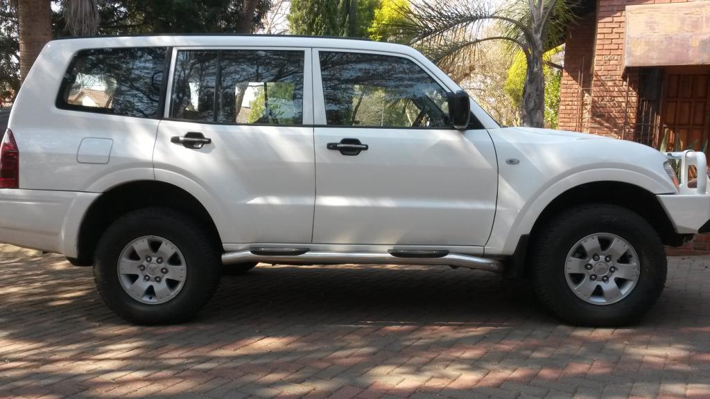

So I have been driving my 2006,3.2,glx,lwb since 182k (when I bought it) and its coming up to 200k (199563km). I only had to replace brake discs all round and I haven't had any troubles. I don't know how the previous owner treated her, but I do oil and filters every 7500km and dose some 2T. I have the slips of the transfer case and diffs oils done at 180k. I have the following questions:
1. Should I start looking at injector tests?
2. Should I start looking at CAM chains or guides?
3. Should I start looking at the newer models?
She goes so well a.t.m. I am afraid if I start "krapping" something will get messed up.
She has the following mods:
Color coded rear bumper and front ARB
Dual battery system
Bash plates for diffs, engine and t-case
16" Mag rims with 265/70/16 Yoko G012
50mm lift from Stofpad spacers
